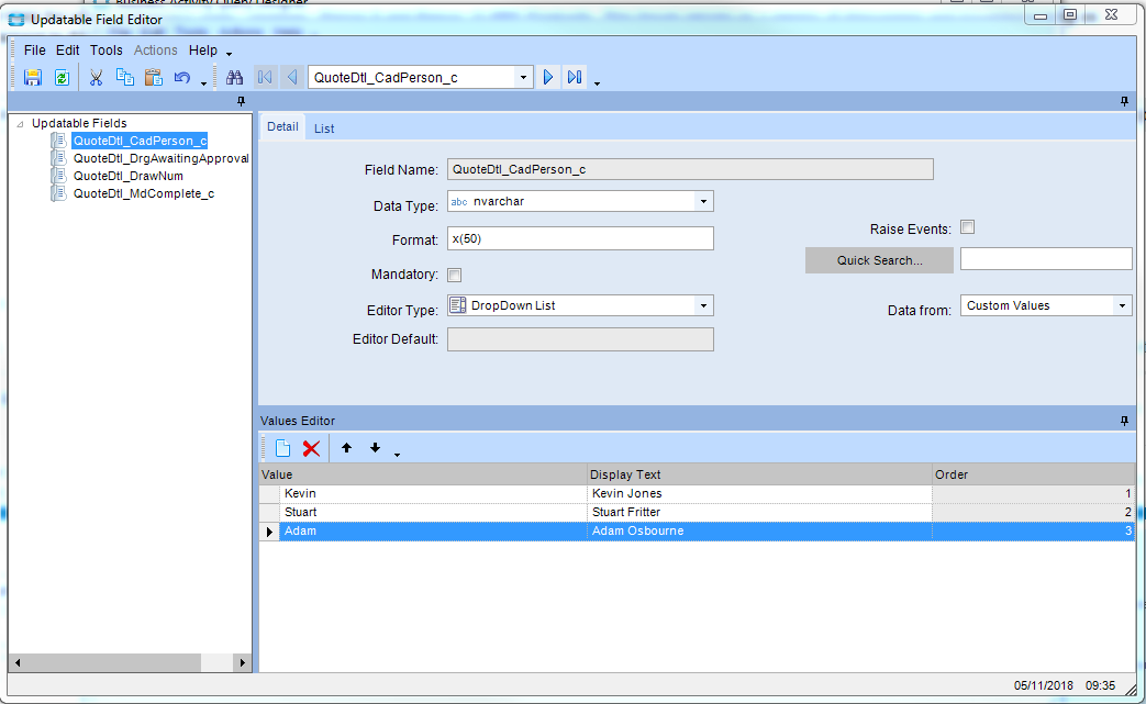

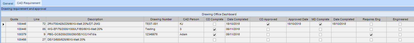

I am trying to get a dropdown box to display on a dashboard, so far without much luck. I have added it to the BAQ like this;
The column shows and when I double click I can update it.

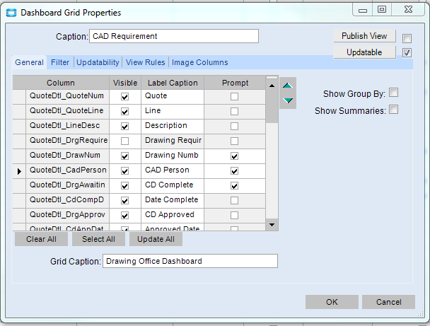

When I create the dashboard the column shows, but not as a dropdown, and when I test / deploy the dashboard the column is not there at all. I think I may have missed a step or something. Has anyone done this successfully before and can point me in the right direction?

could you screenshot the field on your updatable dashboard ?
Here is a screenshot of the dashboard in ‘Dashboard’ mode
and another showing the deployed dashboard with the missing column.
Adrian.
sorry for asking this obvious question…is the field CAD Person marked as an updatable field on the dashboard query properties ?

then, my last suggestion is to deploy it again, clear your client cache memory, log off, log back on, then call your dashboard from the dashboard maintenance not form anywhere else, please let me know if that worked
Thanks Al, I tried all that but still no sign of the field when I deploy the dashboard :frowning:

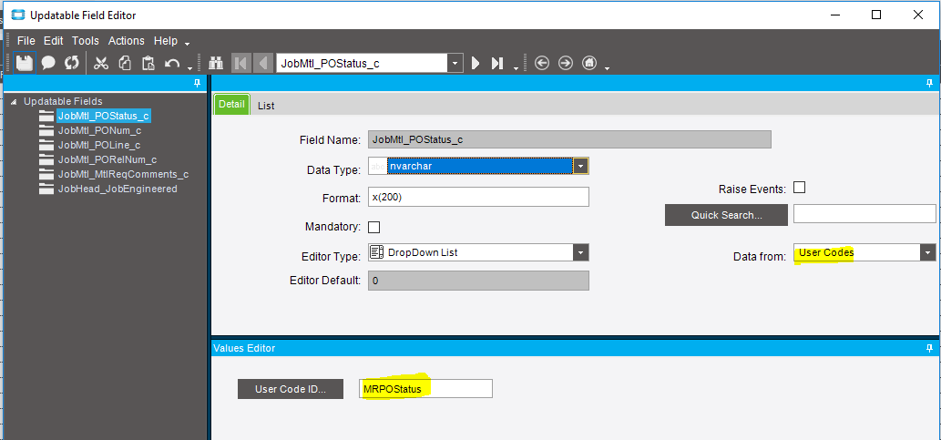

i never used it, so i can not be sure, it could be a bug, but what i have used in many of my dashboards is a User Code and BAQ options, would you like to try them and see, if CAD person refer to Epicor Users/Employee/ or contacts then i advice you to create a simple BAQ displaying what ever you want to see in your dashboard drop down list then link the dashboard BAQ updatable field to this BAQ query, if not define a user code list and use it…i am interesting to know if this will work in your Epicor environment or not?

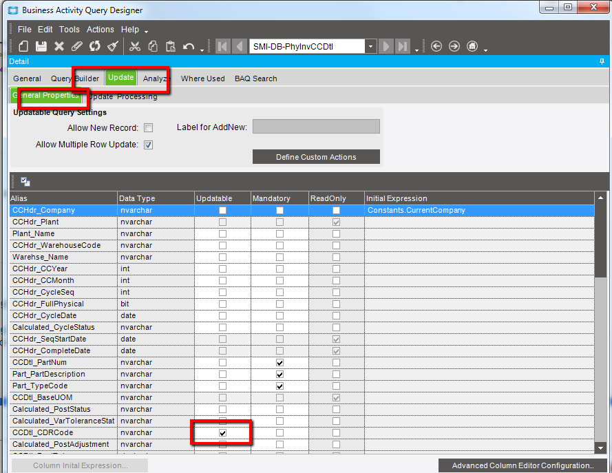

@Adrian_Mepham make sure that field is set as an Updatable Field in these tabs within the BAQ.

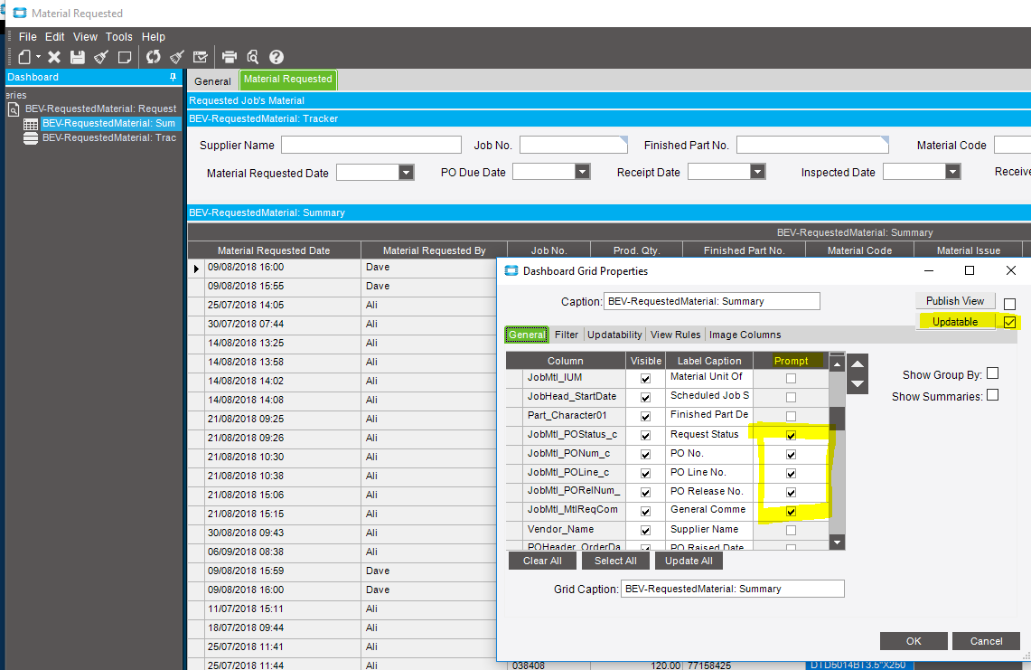

Then when you hit Get List under Analyze, and you click Update will it be a drop-down. However, ONLY in a Dashboard it will be a drop-down right on the Grid itself.
BAQ:
Dashboard:

What you have there is exactly what I have done, using the update in the BAQ works as you describe. It’s just that the field does not come through on the deployed dashboard. I have a support call logged but have not heard anything yet.

If you have added the field after you have already started on the Dashboard, it will not become automatically visible on the Dashboard, you have to edit the properties (that dialog box that lets you select fields in the dashboard) and typically the field will be all the way on the bottom with the visible checkbox not checked.
