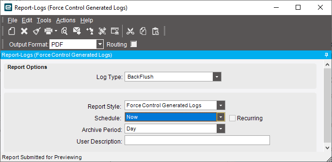

When I launch the report, I get the expected dialog with the configured criteria prompt. When I then attempt to launch the report, I find an error in the System Monitor as follows:
Query execution failed for dataset ‘BAQReportResult’. —> System.Data.SqlClient.SqlException: Invalid object name ‘BAQReportResult_5c8317b388954c75af01c477f5ed93fd’.
Checking the SSRS server logs, I see this type of error for every configured dataset within the report. This would make me believe that the system intended to generate data and push to the SSRS report database, but the data isn’t actually there.
I have made sure to have the Archive Period = Day.

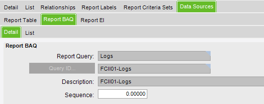

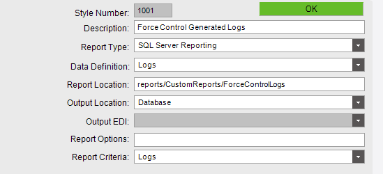

I have also verified that the Output Location for the RDD = database
Did you name your data source BAQReportResult in the RDD? That’s what I’d expect the name of the data source if you used an actual BAQ Report… but for a RDD-based report you are speaking of, you name each of the BAQs you add to the RDD and I believe the table they go into bear that name. Your SSRS should be referencing the data source names from the RDD. Can you double check that?
Thanks for the reply @dr_dan.
No. The name of the data source in the RDD is named “logs”.
The SSRS report shows that data source name along with other “out of the box” included data sources. None of them show up as table data in the SSRS database.

@utaylor, I recreated everything ditching the ‘-’ symbol for both BAQs (Data Source and Criteria Prompt), but sadly, it made no difference. Not sure if I would have to blow away the RDD and start completely fresh, but just removing and adding the “hypenless” BAQs didn’t fix it. Like you, I have been using this convention for years so I hope I can still use the convention.
