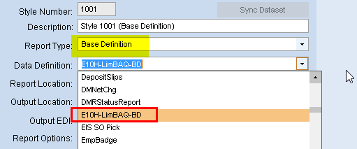

  2. Say I got #4 set correctly, now I add the Report Style to the ID. What Report Type should the Style use? My first guess would be that it should match the Type from step #2.

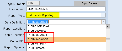

If I choose Base Definition I only see the RDD whose Type was “Base Def”
If I choose SQL Server Reporting, I see both RDD’s (the “Base Def” and “SQL Serv…”)

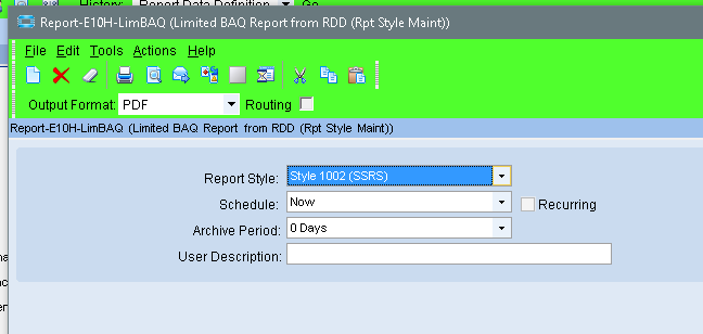

I’d have thought that was all that needed to be done. But upon testing the form that shows when launched from the menu item (#7 above), doesn’t have the criteria prompt

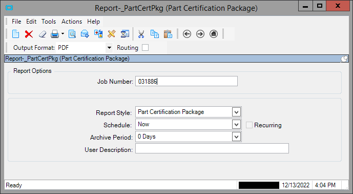

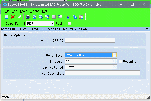

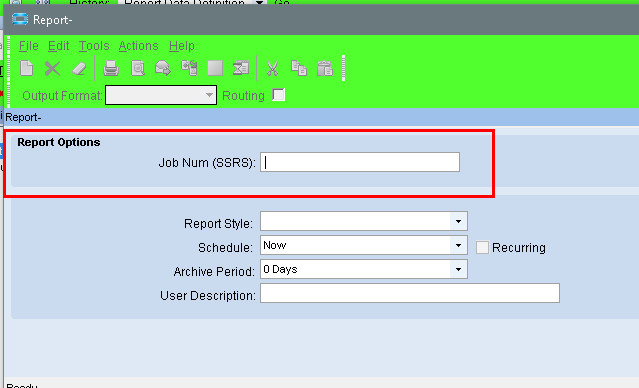

When I use “Preview Submission Form” in RDD entry, I see:
When I launch the form from the menu item I created I don’t see the Report Options
I’d really appreciate someone pointing out that one (or more ) stupid thing I missed.

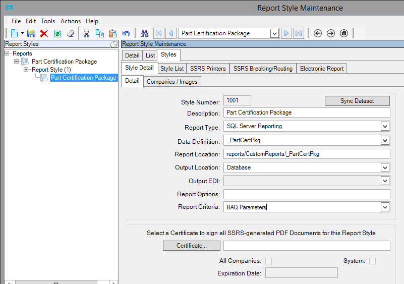

7b.Did you select the Criteria Set in the Report Style?
No I did not … (I knew it was something simple!!)
And one thing that I didn’t realize… Since the Criteria Set is tied to the Style, selecting a different style on the report form , changes the criteria displayed.

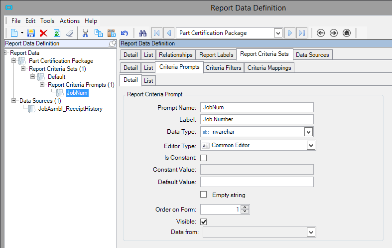

I am getting the following error in the System Monitor: “Mandatory parameter values are not specified for ‘JobAsmbl_ReceiptHistory’ BAQ: JobNum”.
RDD criteria:
From the Report Style:
Report menu item:
Edit: I solved the problem…I forgot to enter a Control Type and Name:
