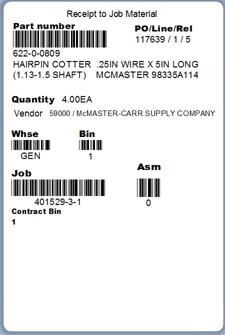

do you have some reports that I can use for this? Just want our possibilities are for our receiving labels
The site won’t let me upload bartender files. But here is a label that we use for receipts. This one prints on a 4x6 label from the zebra print, but we have other reports that just print to a paper printer, (like the one shown below)

Could you send me the bartender file direct? gpayne @ compulink.com or put in a zip here?
I have Bartender and have never used it.

I’m not at work today. Did you try making one from scratch? It’s really not hard and by the time you end up modifying one of mine, you would have been better off making yours from scratch. It really isn’t much more complicated than PowerPoint.
No worries. I have not looked at it at all since we bought it. I will give it a try sometime and shout out if I need help.
