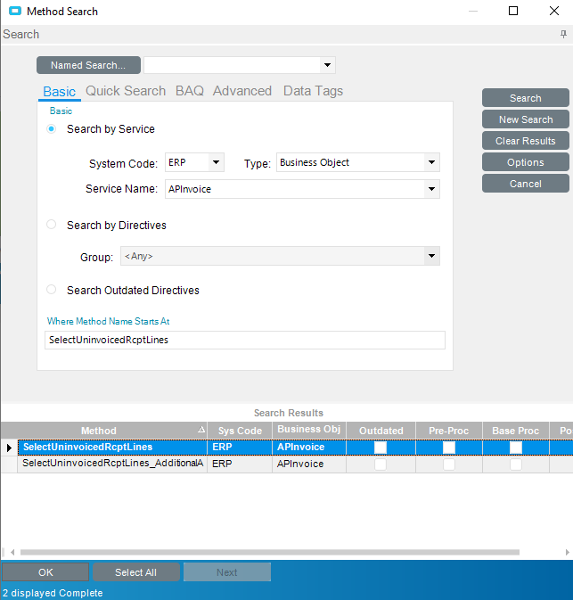

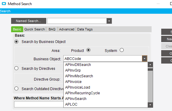

The business object you want is APInvoice: (my screen will differ due to the version)
You can always remove the “impl” from the object as it is a specific implementation of the parent object. This is an object-oriented programming naming convention. It was more important when there might be an SQL implementation vs a Progress implementation, etc.
Thank you, I was wondering why Trace was so useful for others when I couldn’t find any of the BO that I had when I ran it lol. Cheers
