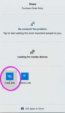

In the newest version of Kinetic, there is now a “Share” option on most screens. When you choose it, you can get a “deep link” that you can send via email. You can also build your own version of that once you see the format. The link you get from Purchasing looks like this link… note that the “channelid” is currently required, but you can set it to zero with no security concerns (just validated this yesterday by Dev team).
https://your.computer.com/ERPCurrent/apps/erp/home/#/view/PMGO2001/Erp.UI.POEntry?channelid=440115fe-0b51-425a-82c2-9294540d284a&company=EPIC06&site=EVN&pageId=Details&KeyFields.PONum=4261
I found that you can shorten the link for the PO above to THIS:
https://your.computer.com/erpcurrent/apps/erp/home/#/view/PMGO2001/Erp.UI.POEntry?channelid=0&company=EPIC06&KeyFields.PONum=4261
