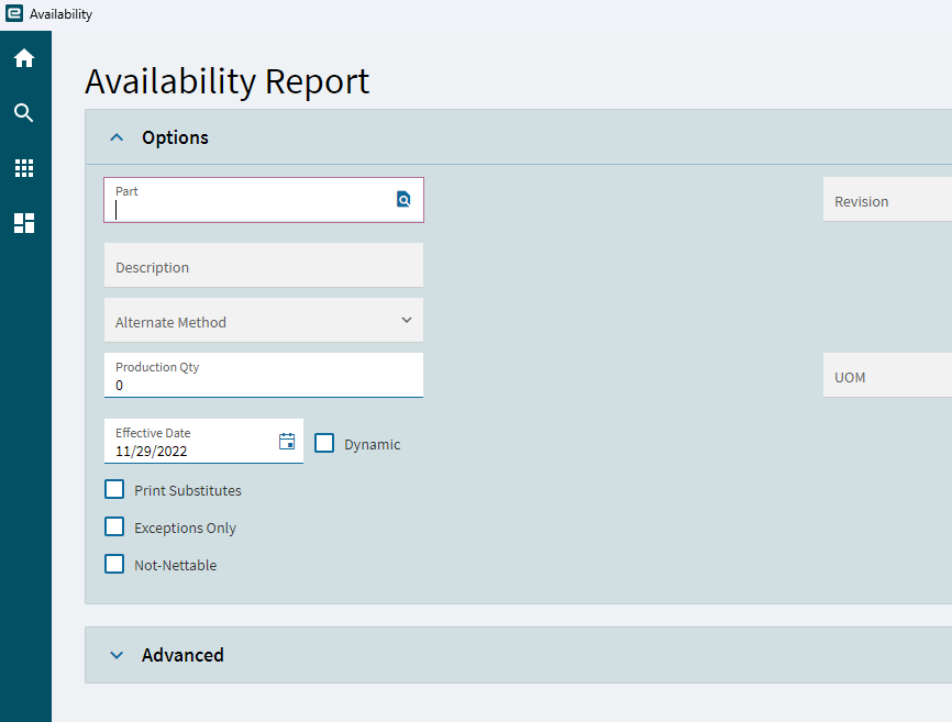

Hello Robert,
Have you looked at the Availability Report under Engineering? It seems to do what you’re asking.
@Mark_Wonsil I had never seen that report before. It is very nice. Oddly enough I happened onto very close to what @RPLEGRAND described in this post. It is @timshuwy’s bom_explode baq in the thread below. It is a little slow depending on your setup, but some people have added company to filters to make it run better.

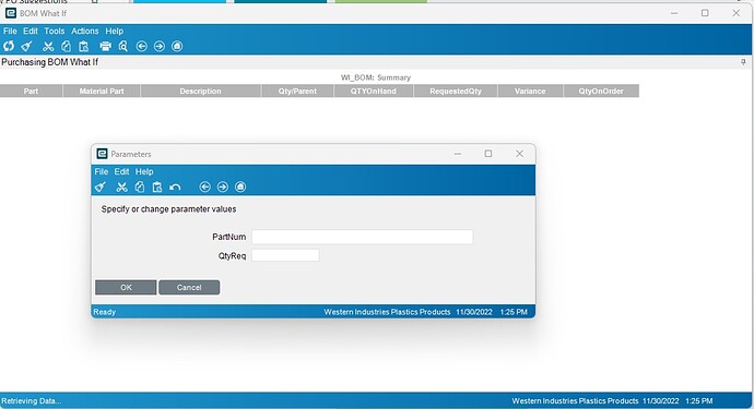

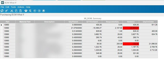

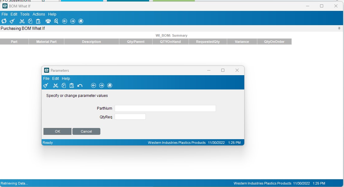

Use the PartDtl table. You can get everything you need from it. It’s like time phase, but with all the parts.
WI_BOM.baq (38.5 KB)
Attached - Key in part and what qty you want to run:
Returns The parts with parent qty from BOM, Qty on hand, Requested qty = calc field, Variance, and what is on open purchase order for the part.

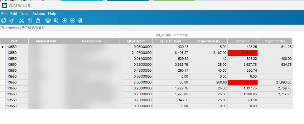

I removed your parameter and added one called “PartNum_Pipe_Qty”
I populated it as follows
PartNum_Pipe_Qty = partnum1|qty1,partnum2|qty2
[Part][PIPE Character][Qty][Comma][Part][PIPE Character][Qty]
I added two new Subqueries:
ParameterBreakout & ParameterBreakout2 (to lose nulls)
//I made it a CTE, but you don't have to
with [ParameterBreakout2] as
(select
	[ParameterBreakout].[Calculated_PartNum] as [Calculated_PartNum],
	[ParameterBreakout].[Calculated_Qty] as [Calculated_Qty]
from  (select top (100)
	(ROW_NUMBER() OVER(ORDER BY PartTran.TranNum)) as [Calculated_RowNum],
	([Ice].entry(1, BreakOnComma, '|')) as [Calculated_PartNum],
	([Ice].entry(2, BreakOnComma, '|')) as [Calculated_Qty],
	([Ice].entry(RowNum, @PartNum_Pipe_Qty, ',')) as [Calculated_BreakOnComma]
from Erp.PartTran as PartTran)  as ParameterBreakout
where (ParameterBreakout.Calculated_PartNum is not null))
I added the ParameterBreakout2 query to your SubQuery1 and linked it to
Part on Calculated_PartNum = Partnum
I removed your parameter from Part.
I replaced your parameter on RequestedQty with:
(PartMtl.QtyPer * ParameterBreakout2.Calculated_Qty)
Last I added ParameterBreakout2.Calculated_Qty to your Display Columns, and selected Group By
You can thank @ckrusen & @jdtrent for the hints
I can try to explain anything if necessary.
The formatting of your parameter strings could be changed if this doesn’t work
for you. Just needs to be easy to parse.
WI_BOM_Modified.baq (75.2 KB)
