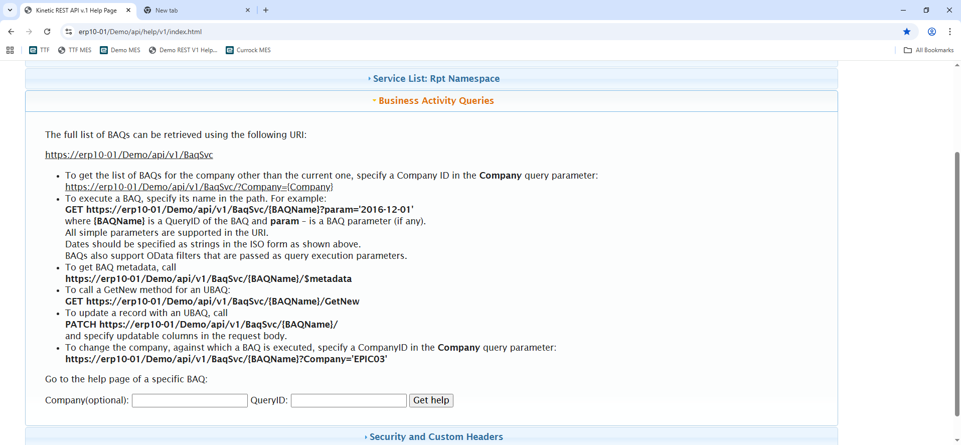

I create BAQs that contain the “raw data” that I need in Power BI etc. I call these using an OData connection (as per the API help for v1):
Once the “raw data” is in the Data Model, I use the standard Power BI tools (i.e. DAX/Widgets) to create the calculations/visualizations that are needed.

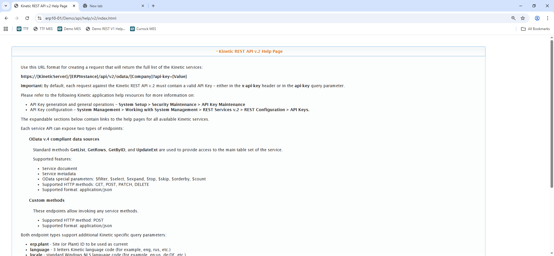

The connection method for REST v2 is similar, however you need to have created and pass in the appropriate API key that you have setup through the front end of Epicor:
