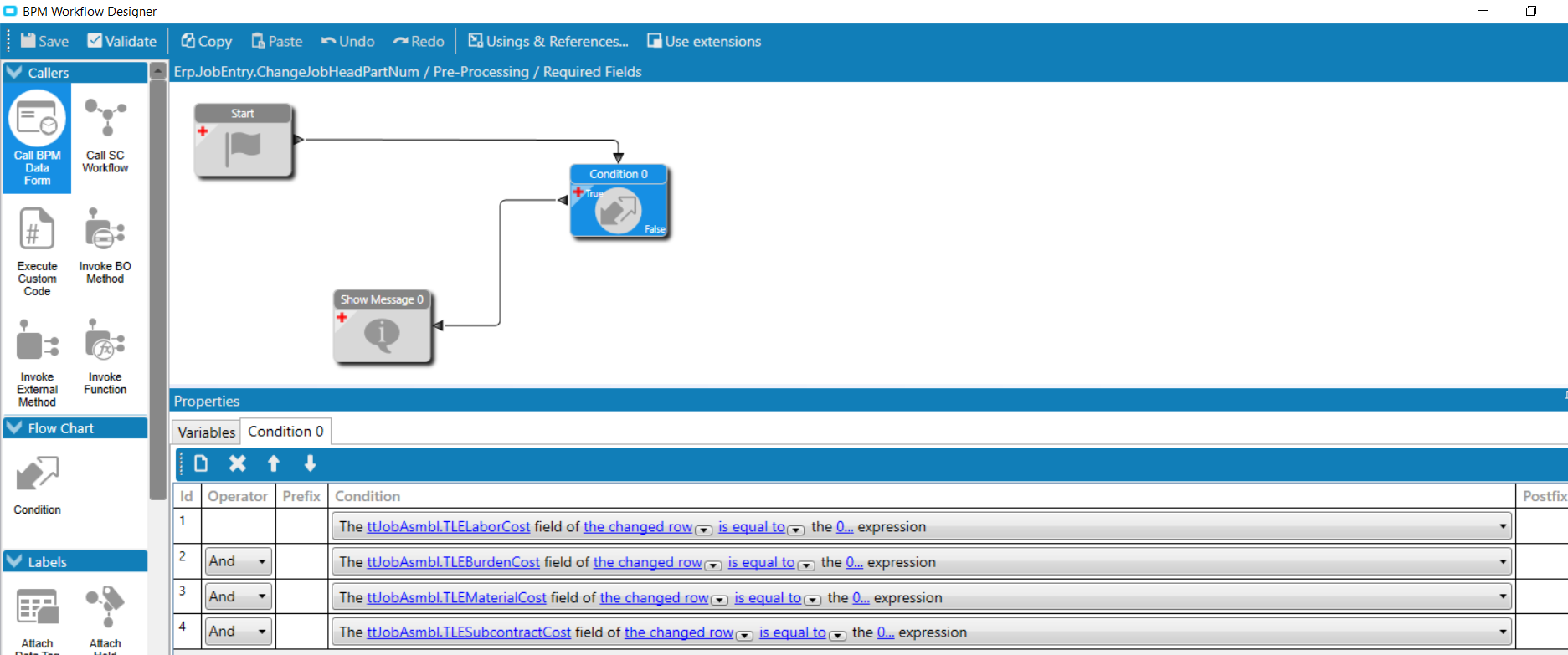

Im still not getting the desired outcome. I believe it may be because of the fields that I am using.
I have the TLE fields, which are calculated based on the standard cost of the parts, selected because the part cost table is not used within the JobEntry method. Am I looking at this the wrong way? Thanks for the help!
The Job Assembly table isn’t going to really be touched at this point.

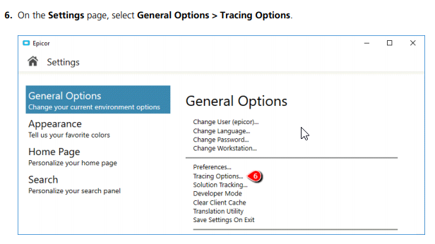

See Ice Tool Guide
Pages 889 - 896
But the short of it is in your Settings there is a Tracing Options Program which you can enable to see the different methods and calls that Epicor Makes (including the data sent, received and changed)
I highly recommend you get familiar with this tool since it is your life line in most situations.

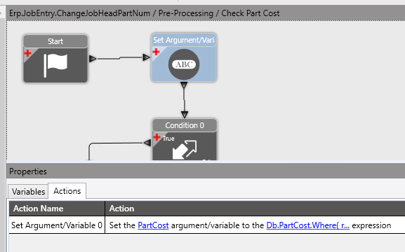

You can create a variable and set it with a Set Arg/Variable widget. You fetch the StdCost in the expression like:
with the expression:
Db.PartCost.Where( r =>r.Company == callContextClient.CurrentCompany && r.PartNum == ttJobHeadRow.PartNum).Select( r =>r.StdMaterialCost).DefaultIfEmpty(0).FirstOrDefault()
You might need to make it the sum of the various PartCost fields related to Std cost
+ Db.PartCost.Where( r =>r.Company == callContextClient.CurrentCompany && r.PartNum == ttJobHeadRow.PartNum).Select( r =>r.StdLaborCost).DefaultIfEmpty(0).FirstOrDefault()
+ Db.PartCost.Where( r =>r.Company == callContextClient.CurrentCompany && r.PartNum == ttJobHeadRow.PartNum).Select( r =>r.StdBurdenCost).DefaultIfEmpty(0).FirstOrDefault()
+ ... and for StdSubContCost
+ ... and for StdMtlBurCost
The have your condition use that variable to see if it is <= 0
