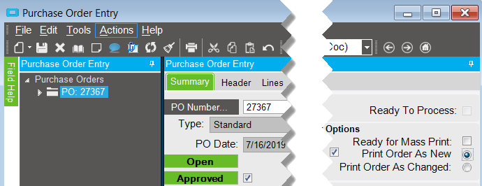

After printing a Purchase Order, PrintAs is set from “N” to “C” automatically. We’d like to disable this behavior and instead only allow PrintAs to be changed to “C” manually.

I do something like this for mass print. Add a checkbox to poheader that is set in PO.GetNewPOHeader post processing directive to true. if the checkbox is still true when the data directive fires have it set PrintAs to “N”. Your user would have to uncheck and set print as to changed.
Thank you both! I think I’ll try to make a “lock PrintAs” checkbox a try and integrate it with BPM logic.

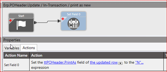

This goes on a data directive, which you can see in the image is POHeader.Update and forces the value unless your checkbox is set.
my condition
my action

To start add the action to an in-transaction data directive to see PrintAs to “N” without any conditions. I made this and printed a few times and PrintAs stays New.
Then add the condition if your checkbox is false.

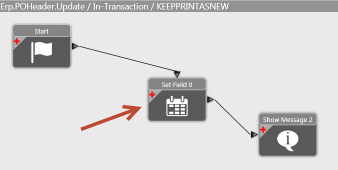

I’m still having problems getting the BPM to acknowledge that the checkbox exists:
BPM:
Set Field:
Actual PO Entry shows an update message with the value of PrintAs and the value of the checkbox, which is bound to CallContextBpmData.Checkbox01
When I actually print the document, it seems to lose that BPM Call Context data. This screenshot is after hitting “print preview”. The checkbox remains checked, but there was no update message that popped up, and something updated “PrintAs” to “C”.
It seems odd that the PO Header Update method would be called but no message box would pop up.
You need to add a UD field to POHeader and regerate the schema. Bind that new field to the checkbox.
In a in-transaction data directive if the new checkbox is false then set PrintAs to N
