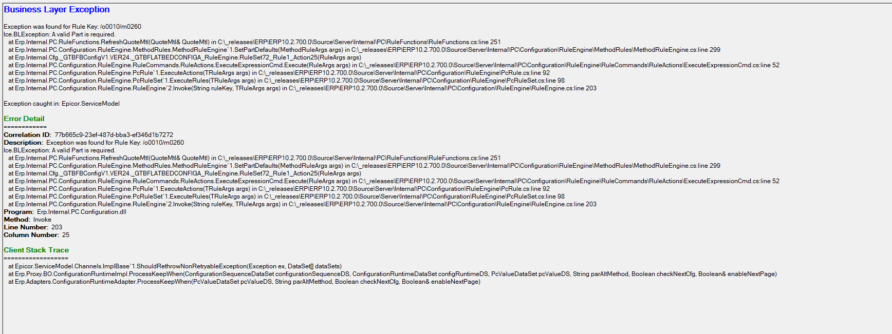

I am still in the building phase of our Config, I’ve reached about 90% done, but this morning when I fired up EPICOR, and tried to test the Config in a quote, the Config opened, I made a few selctions then got this error!
Being a novice at this, I have no earthly idea what to do. Can someone plz help with what direction to begin moviong in?!

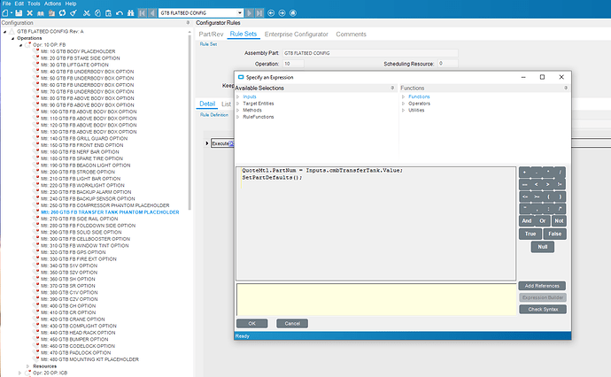

It has been a minute since I’ve messed with a configurator, but you are trying to set material 260 using a rule, correct?
I believe this material is tied to operation 10.
You are setting the material part number with a rule and the part is null or invalid.

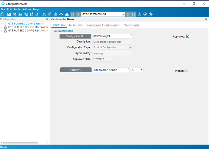

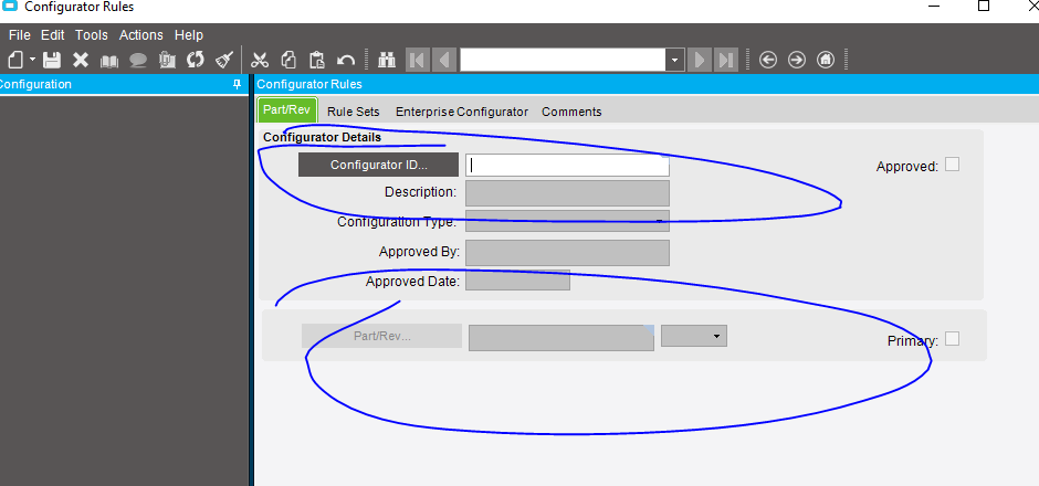

Open the configurator you are using in configurator rule entry and then type in the part that you are configuring- see screenshot.
