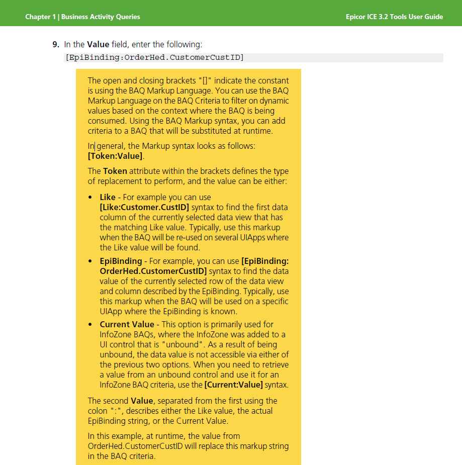

Any EpiBinding experts? I found this in the ICE Tools and was trying to use [EpiBinding:OrderHed.OrderNum] instead of [EpiBinding:OrderHed.CustomerCustID].
[EpiBinding:OrderHed.OrderNum] throws an error when I analyze but oddly as the document shows {EpiBinding:OrderHed.CustomerCustID] does not throw an error.
