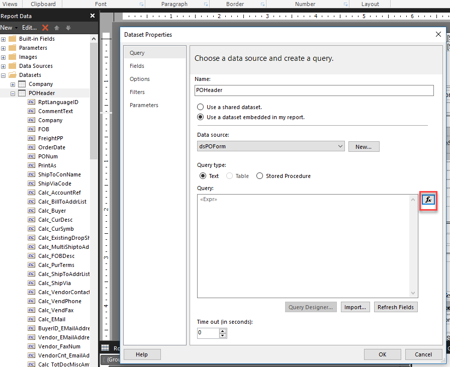

If you’re going to use this field in a SSRS report, you’ll need to add the UD field to the report’s DataSet. For PO it’s the POHeader dataset.
