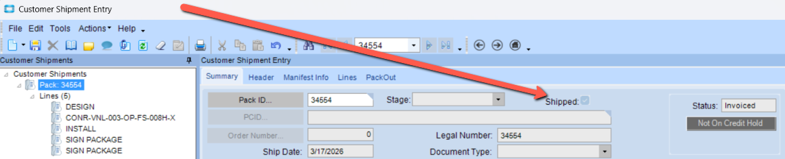

I have a pack ID in the Customer Shipment Entry that has been marked as Shipped…

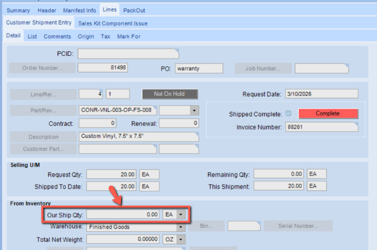

I need to change the Our Ship Qty field but can’t. Is there a way to do this that I’m missing?
According to your screenshot the shipment is invoiced so you can’t make any changes to it unless that invoice gets walked back first, then you would have to ‘unship’ the pack before you can edit it.
