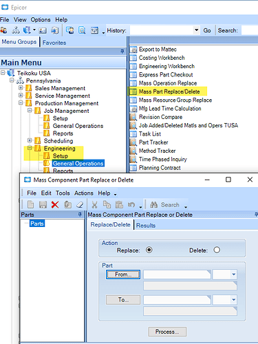

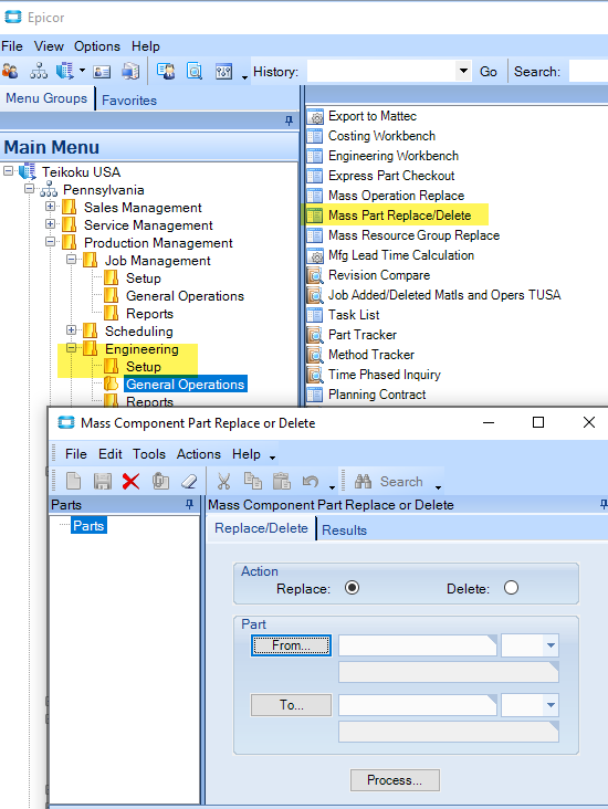

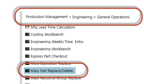

DMT works and you can also try the Mass Part Replace.
Warning on DMT if you have unapproved revisions that you update, it will approve them after the DMT update. You will need a second DMT to reset approval status
One note about mass part replace… it doesn’t bump the revision of the part. it simply changes the part number. IF that is what you wanted, that is great.
