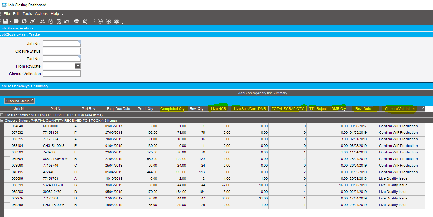

Epicor standard functionality is logical, jobs can not be closed until all NCR/DMR been dealt with, so in order to monitor this process i have created a dashboard to check Open WIP Jobs with received to stock qty, NCR qty, scrap qty, and DMR rejected qty, once the four numbers matched then raise a flag to close the relevant job, production planner to check this dashboard daily, however you can schedule a task to scan through this BAQ and alert whoever you want about an open Job need to be closed

This would be a great tool to use. I’m afraid my Epicor skill will need some expansion to build something like this.
Currently, I am spending an unnecessarily long amount of time back-tracing from Job Tracker to identify which NC items are related to a job, then moving them through NC/DMR. Many of our items may sit for several months before they complete a recondition/quarantine period for final evaluation. The issue is that I have many part numbers, many of which have many lot numbers in a small period of time, and failures are created daily and/or by job completions. It is a lot of hands on management of individual line items.
Definitely some improvement needed on our end! I will look into creating a dashboard similar to yours. Thank you for the help!
