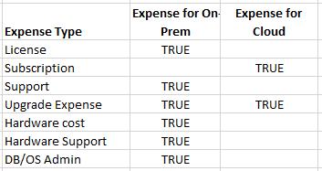

one thing that people dont always consider about running in the cloud is the total cost of ownership for Cloud vs On-Prem… Over a 5 year period, the TCO is higher for on-prem… Compare the types of cost for each:
So once you move to the cloud, you no longer need to be concerned about server hardware & support. DB/OS admin, backups, etc are taken care of. Your current License and Support are converted to a subscription. The only expense that is there for both models is the Upgrade expense, but even then, it goes down in the cloud because Epicor does the actual process of installing and running the upgrade over a weekend for you.
