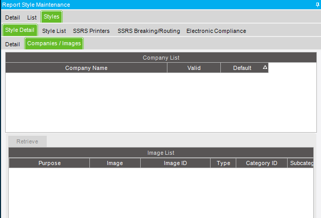

Hey Joe,
I thought that Epicor added this to the standard functionality. Now maybe you’re running multiple companies in a single Epicor company but in Report Style Maintenance, there is a place to to place conditional images based on company. I’ve never used it and not sure which release it started.
Not sure about that. Interesting. I’ll have to check it out. But this “company” is really a brand, so they could have invoices with three different logos and contacts in the same invoice group.
I did get it working with Doug’s suggestion of ReportItems.
