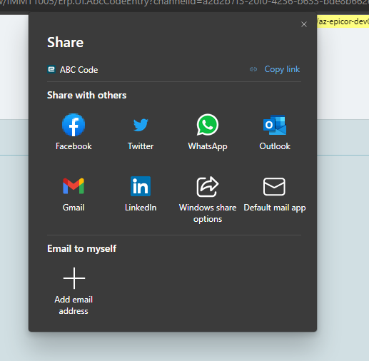

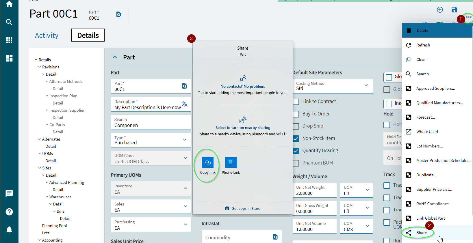

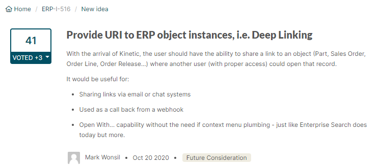

so yes, Idea ERP-I-516 is complete in 2022.1… when you the menu in any screen, there is now a “Share” menu option. If you choose the menu, you get a SHARE pop-up that allows you to press “Copy Link”… if you put that link into an email and send it, the person who receives it will be able to follow the link directly to the application and the record you linked to. They OF COURSE will need to log in if they are not already logged in. The deep link looks like this:
