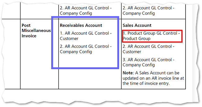

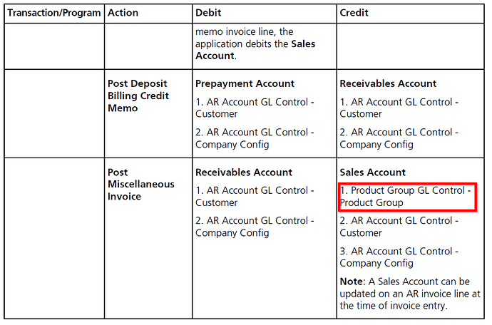

I checked the AR edu document’s appending on Hierarchies, and the ‘Post Miscellaneous Invoice’ section for Credit does show Product Group on the sales account, but not on the credit side. The credit side seems to only go with Customer, then Company Config. I’m not sure if that would work, since the issue we have is crediting the wrong receivables account.
We use Product groups in this exact way. I just thought you were looking to change the debited account (as this thread’s title is :" … Change Debit AR Account …")

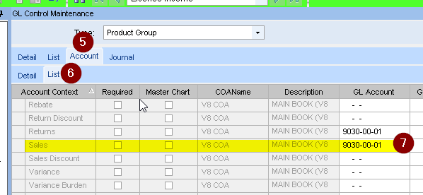

If it is actually the Credit side that you want to change, here’s the steps:

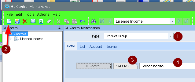

Create a GL Control Code (in Fin Mngmnt -> General Ledger -> Setup) of type “Product Group”
Set the Sales Account

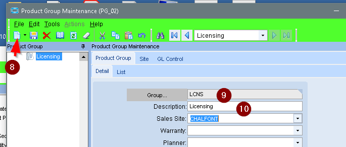

Create a Prod Group for these “Leases”

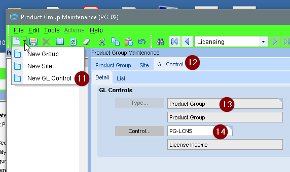

Add the GLC from step 1 to this product group.
If a part master entry exists for the “Lease” items, set the Product Group
Now anytime the “Lease” part is referenced on an Order, the Prd Will automatically be set.
And you can manually select the Prod group on an Order or Invoice line, to override the parts default PG, or if it is an On-the-fly part.
FWIW - I tend to name the GLC Code with a prefix for the type (PG for Prod Group), and the PG code it will be applied to.
