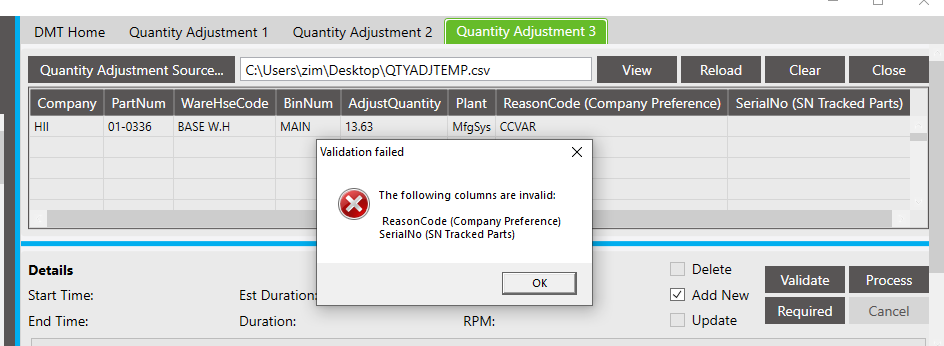

I make a template and fill it in. The template tells me the following are required when I validate it. All columns are valid. I hit Process
So I add these two optional columns. I can validate, but get the same error again when processing.
What is odd is if I rename them to this I get this error here when I load the file, (error at vaildate)
But I can actually process the file now! But then I get this error

I dropped it to one row, this should be valid.
This is expected and should give an error. But it is the only way to make it process. That is not expected.
This is what is unexpected. It’s like it is strictly checking for the name in parenthesis. Why it would do this… i don’t know. A software bug?

It really looks like someone who programmed it set two columns as required which can’t be part of the file. I think they wanted an informational error and instead made “SerialNo (SN Tracked Parts)” required instead of leaving it optional, and made “ReasonCode (Customer Preference)” a required field, neither of which are field names - so you could never process. Looks to me to be a straight up programming and QA issue.

Your column headings should be ReasonCode and SerialNo not ReasonCode (Company Preference) and SerialNo (SN Tracked Parts)
Yes Matt is correct. We do qty adjustment dmts all the time and the column names should be ReasonCode & SerialNo
