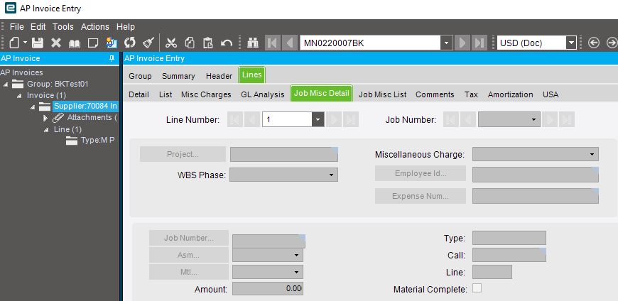

Problem: Our AP department needs to have DocStar invoices include an option for Job Miscellaneous Details. Specifically they want to have Project, WBS Phase, Miscellaneous Charge, and Amount added to invoices (these fields are found in Epicor invoices within Lines >> Job Misc Detail tab. See image below).

Epicor Invoice Image:
