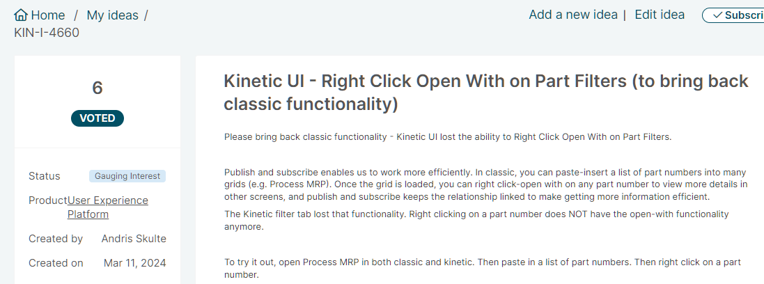

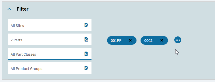

The current gripe for the Kinetic UI for our production control department is that part filters in Kinetic v2023.2 load part numbers into ‘bubbles’. These don’t have the right click open with context menu that’s available in the Classic UI (which loads the partnums as rows in a grid).
Is it a deal breaker? No, but I have no reason yet to move them onto a new UI that slows them down (I did schedule recurring MRP in the Kinetic UI to take advantage of the new active part filters though).

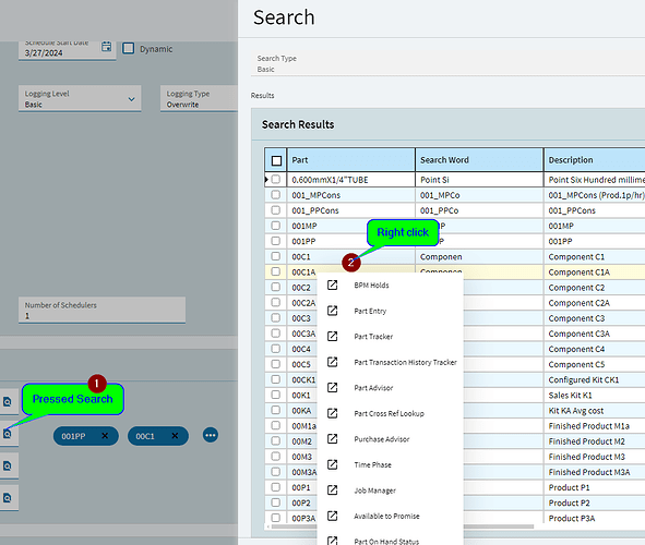

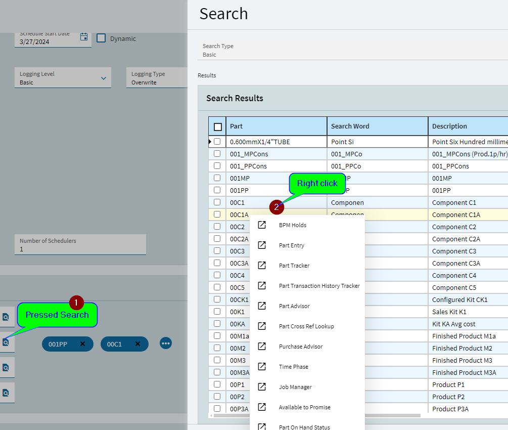

I am assuming you are referring to the bubbles below whenever you apply a filter? Yes, that is a change… you cannot right-click on those bubbles
BUT you can still right-click in the grid on the searches themselves:
Yes - Here, has 6 votes so far: Log In - Epicor Identity

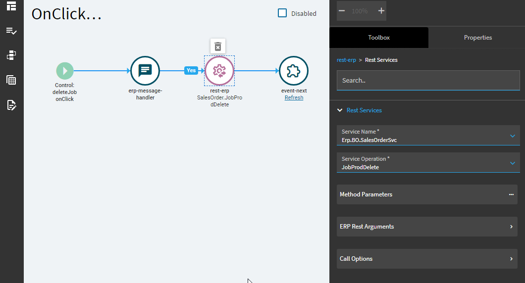

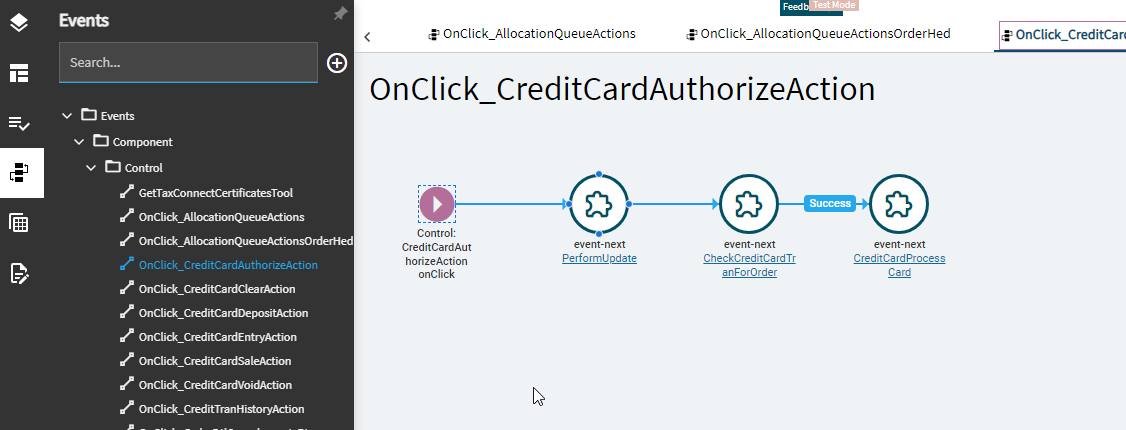

in the old UI, you could write C# code to do extra calculations, then add records to tables, and all sorts of things that would be considered “business logic”… but all the business logic should be done on the server side. the UI should be reserved for User Interface only, but no actual things like calculating commissions, sales tax, etc should be done here.
so, we allow you to call Epicor Functions from the UI, which does all the work and returns the answers. App Studio does have some flowcharting of calling functions, but you cannot write C# code directly inside App Studio.
FOR EXAMPLE… you can create things that are done within the UI that drives events. These events then do things such as call a business object or a UD Epicor Function… but there is not code in the same way as you had in the client.
Here is the “Credit card authorization”… Note that you can now see more than you could before (this was hidden in our old smart client)
Here is another event in sales order for deleting a related job. Note that you could update this to do more stuff if you wanted.
