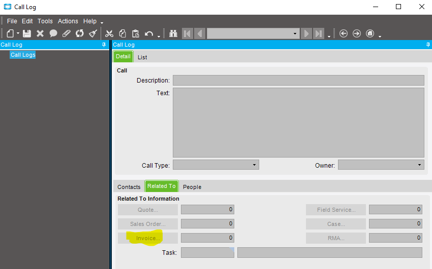

Does you company have the CRM module? One of the things it is actually good for is this kind of contact tracking. You can enter a call and relate it to an Invoice.

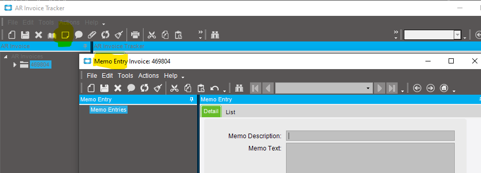

The other option (without CRM) is to use Memo:

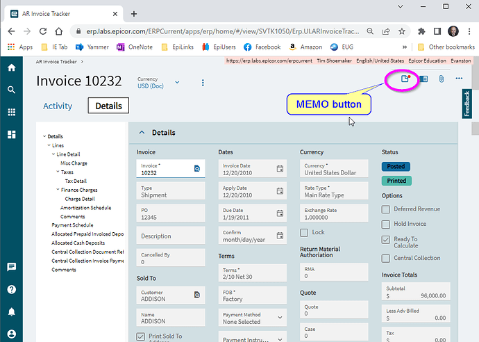

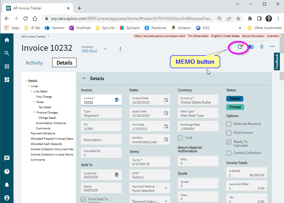

In the category of “did you know”… there are many screens like this that support MEMOs… there is a button at the top to add new memos to any record. (available both in the new UI, and in the old smart client UI).
In the case of AR Invoices, you can even look / modify the memo from the AR Invoice Tracker. You dont need CRM for this. It is just a built in feature. You can create “memo categories” and add new memos.
Note the little red dot? That means that there is at least one memo. Click on the icon, and it will display them.

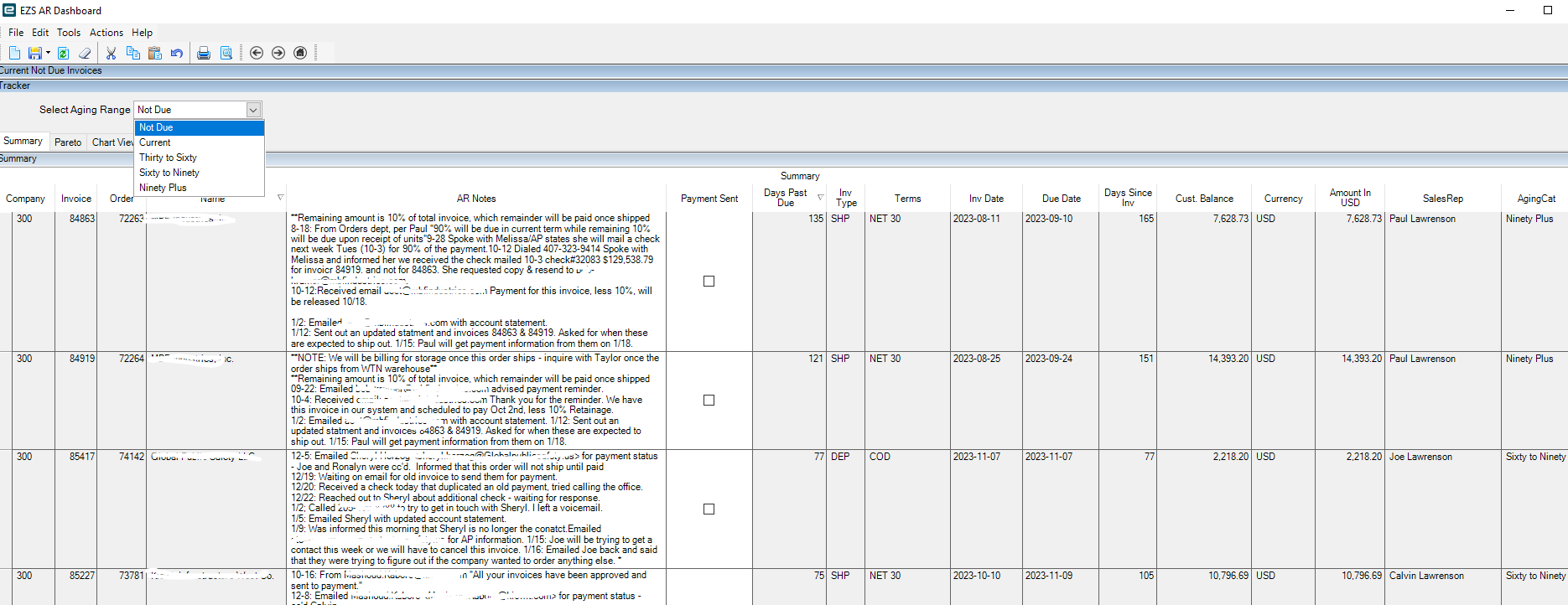

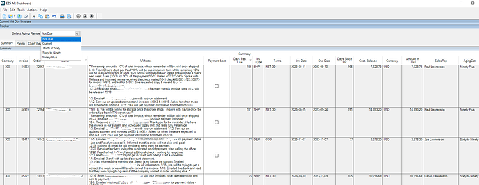

Yes we did successfully deploy an updatable dashboard - and it has been in use since. See capture below. Dashboard can be sorted by aging range and then the user can simply scroll through the accounts and update the notes.
We used the Memo table as suggested above - I can’t recall the issue that was preventing the updating however I believe it was just the business object selection under the update portion of the BAQ
