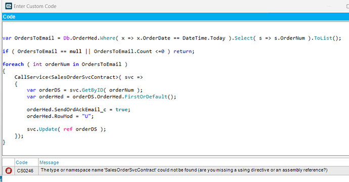

Mr. @kve : Please excuse my script kiddie understanding. I am having trouble getting the function to “Check Syntax”. It is saying the namespace SalesOrderSvcContract could not be found.
I tried adding a Usings of “Erp.Contracts.SalesOrderSvcContract” however that does not seem to help the error.
Any help greatly appreciated:
So to get that added, exit the Code Editor (it will ask you if you want to save with an error, you can say yes). Go to the tab on the library labeled “References” and the sub-tab “Services”, click Add. Find the service called “SalesOrder” and double click.
If it still throws the error, change the call service line to below:
CallService<Erp.Contracts.SalesOrderSvcContract>( svc =>

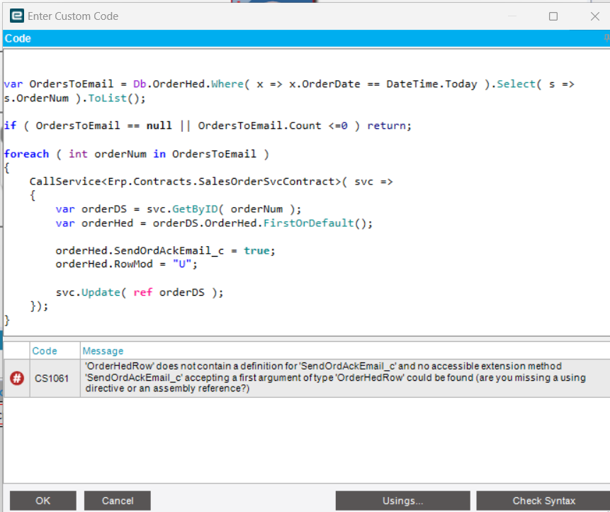

Mr. Kevin: Thank you so much for the help. Yes, adding the Erp.Contracts prefix in the code did get me past that error.
Now i am seeing an error referencing my UD Field OrderHed.SendOrdAckEmail_c

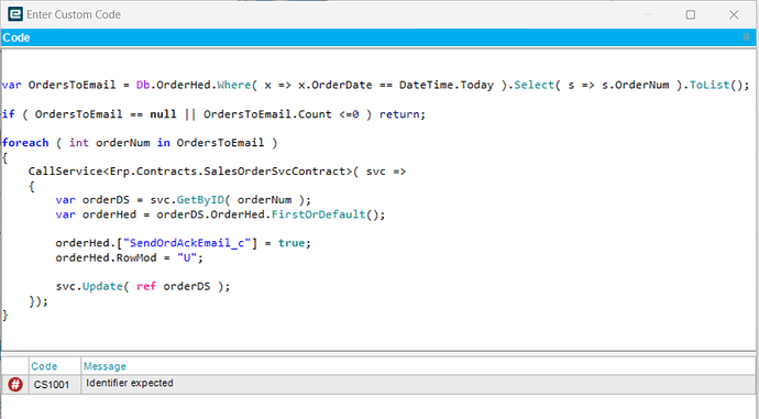

try orderHed["SendOrdAckEmail_c"] = true
Mr. Kevin: Thank you for the suggestion. Hopefully one more help.
Identifier expected

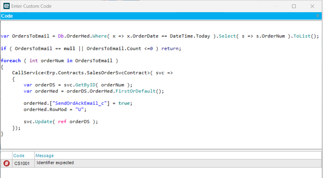

I Finally got it to Check Syntax.
I made changed the one line to orderHed[“SendOrdAckEmail_c”] = true;
I took out the period after the orderHed. Hopefully that is correct? Here is the full code now.

That’s correct, no . after the object when using ["FieldName"] syntax.
