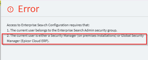

Is there something different between the Enterprise Search URL in Company Maintenance between Epicor 10 and Epicor 2024.1? We can’t seem to get it to work in 2024.1. The Enterprise Search path in the Admin Console matches what we have, but if I click Launch Search from there, it displays a URL that isn’t the same, which fails (unsurprisingly). If I edit the URL to match, I get this message:
Any ideas?
