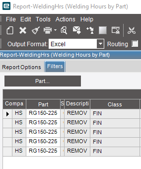

It lets me add the filter, and it lets me select filter values when generating the report, but the report result is not filtered. I opened a case with Epicor support a week ago and so far they don’t seem to understand what I’m asking. I don’t know if I’ve just done something stupid? Or it really doesn’t work? This is the first time I’m building a BAQ report as an SSRS report instead of using the BAQ report designer so maybe there is something I don’t understand.

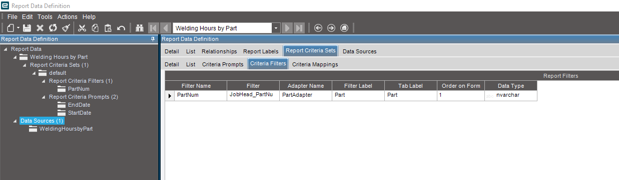

So, in my example, as compared to the steps in the KB, I did not try to use the ‘Criteria Filters’. In my example, I have Prompts and Mappings over to the BAQ, but that is it.
So are you saying you have tried downloading the attachments off the KB and the ‘Filter’ as they describe just is not working?
No I just built my own from scratch - I didn’t try to download the attachments from the KB to compare - that doesn’t look like a complete solution to me? But yeah its just not working. I feel like I probably just missed a step and spent too much time looking at it to see the problem.
Clearly the report knows there is a filter - otherwise it wouldn’t let me choose the filter when running the report. Just can’t figure out why its ignored in the result set. I thought maybe there is something wrong with my BAQ. But if I put a parameter on my BAQ and map it that way, it does get limited to only the part parameter. I’m not seeing in the instructions where any additional steps are needed to get the filter to work, but maybe I’m missing something.

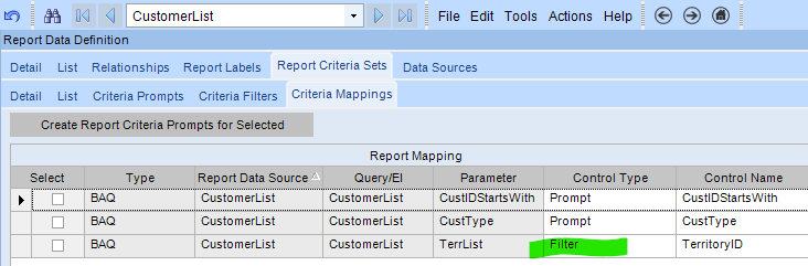

Take a look at your mappings. From the example provided,
Notice that the ‘Filter’ is ‘Mapped’ to the BAQ parameter.
Yes that is what is missing! I somehow missed that the filter required its own list-type parameter inside the BAQ. Thank you so much!!!
