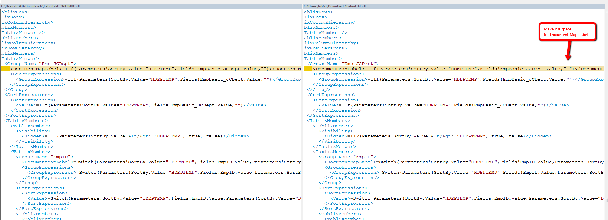

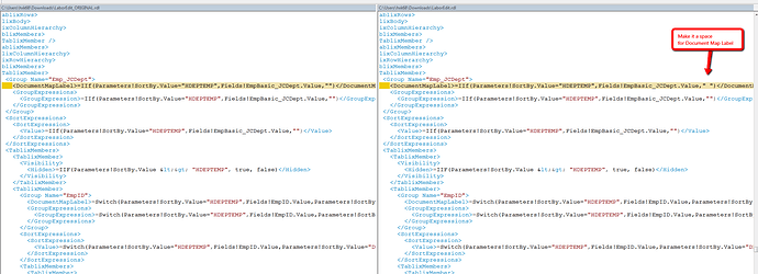

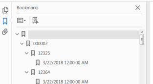

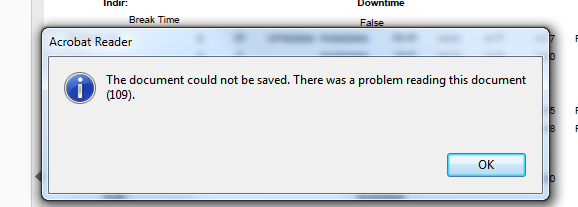

If you have been using Epicor you have probably come across many Report styles that cut-off long text, that don’t word-wrap, in addition .pdf’s that you cant ‘Save As…’ because of corrupt RDL bookmarks (Adobe doesnt like Bookmarks with BLANK Value, but instead a Space).
2018-09-06_1338
Its a bit painful to have to create 50 different Report Styles just to make fields “wider”, because the Warehouse Name is cut-off over 3-4 characters, or the Bank Name or the LOT Number etc… How does this pass Epicor Validation QA? I am not sure.

Does the PDF ISO 19005 standard allow for blank bookmarks? If so, it would appear to be an implementation issue with Adobe Reader. I suspect that is the case as Adobe Reader is the only PDF viewer affected by this behavior.
NOTE: Our dev team has already stated that it is an Adobe issue, and accepted by their support via a forum post a while ago.
@aidacra it looks like you are right its an “Adobe” only issue. I updated to the latest Adobe Reader DC and on reports that have a Blank Heading/Text in the Bookmark, I could not Save As…
So I tried it with Foxit PDF Reader and works fine.

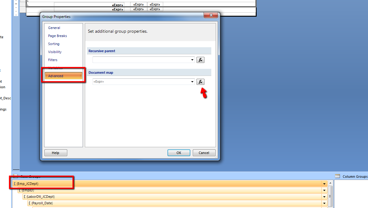

I couldn’t find the issue on any of adobe’s Known Issues KB Articles. The only known workaround I have currently is instead of Save As… Print it to a PDF Printer OR modify the SSRS Report.

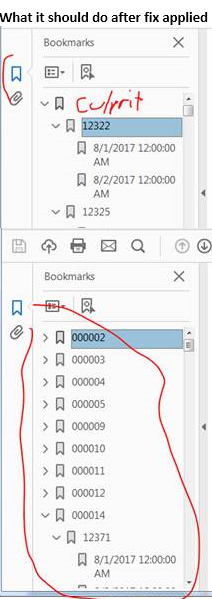

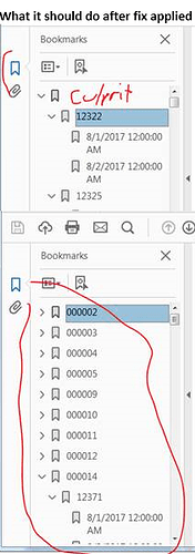

Before:
Error: The document could not be saved. There was a problem reading this document (109).
2018-09-19_2041
After:
2018-09-19_2031

Our work around is to print the PDF file to the PDF printer and name it what you would have done with the Save As… Command.
Mark W
Yep that works as a workaround. Eventually Adobe will fix its Bug, so it would be stupid to modify 100s of reports. But if you google the error, you will see 100s of unsolved cases and I couldn’t find that bug anywhere on Adobe’s Known Issues Lists. They mentioned several times “It’s been fixed” but I think that is a common corruption error and they might not know about the “Bookmarks Blank” Bug yet. If anyone has an account with Adobe, send them to this Forum post :slight_smile:

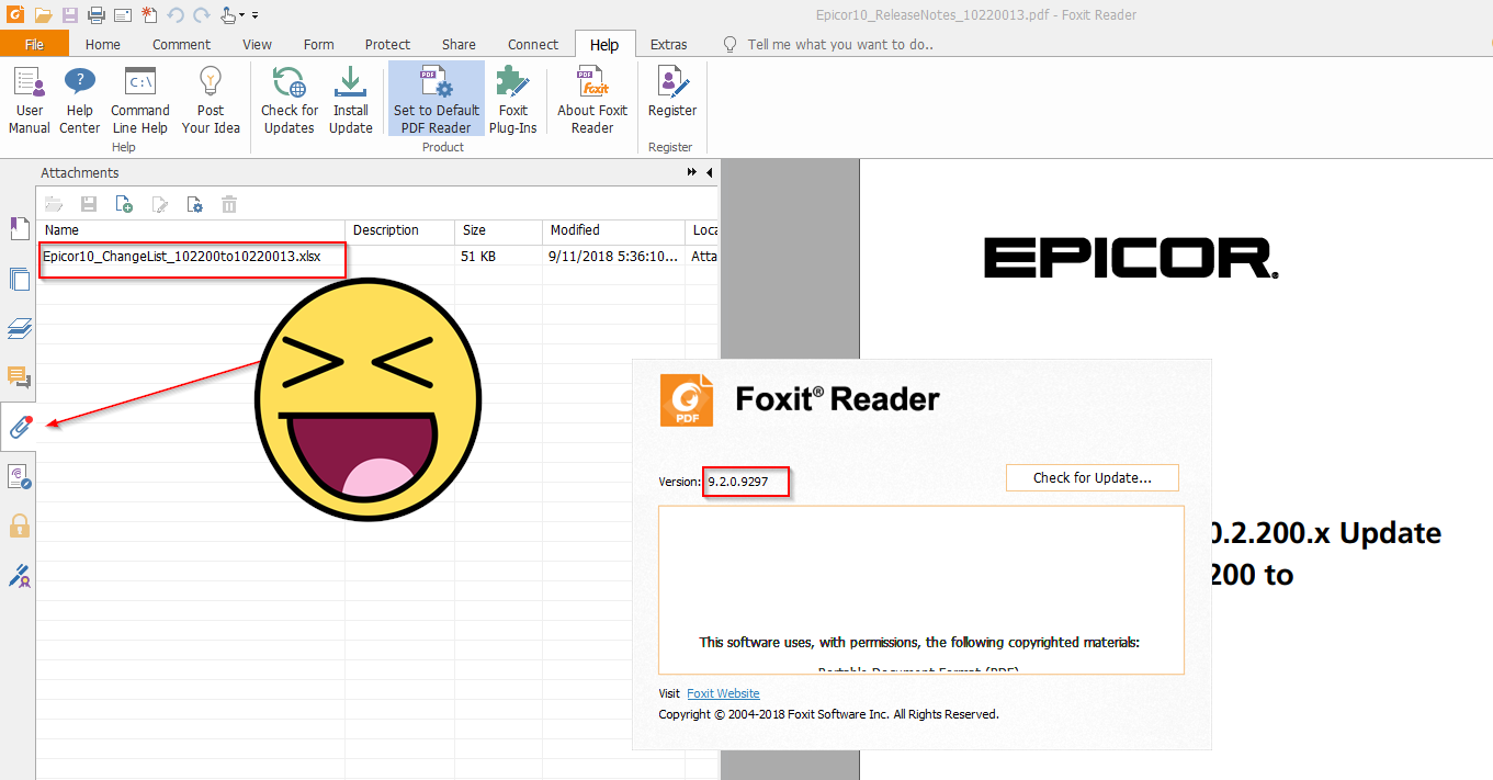

Hmmm can you open attachments in Foxit? If not we are doomed to never get a decent searchable/filterable list of changes on the release notes. :grin:
Smiley face added for dramatic effect.
