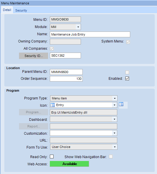

I thought ALL forms/menu items were going to be available in Kinetic in version 2021.1. However, I’m seeing a ton of missing menus when I login from a browser. I’m also not able to change many menu items in the classic client to “Kinetic” in the Form To Use drop-down. Here is just one example. Am I the only one experiencing this, lol? I’m thinking I must have something setup wrong. Thanks in advance for any suggestions!

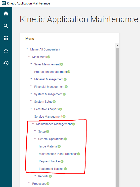

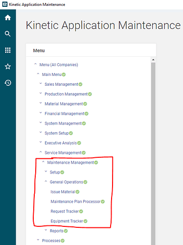

Thanks for the reply, @timshuwy. This is Maintenance Job Entry though, not (production) Job Entry. When I go into Kinetic Application Maintenance, this menu doesn’t show anywhere. Screenshot below. Same story for many other menu items as well like Business Activity Query, Data Directive Maintenance, User Account Security Maintenance, Dashboard, and so on.
