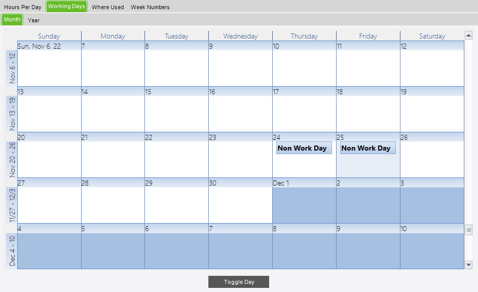

Did you check your calendar to make sure those are active working days?
Will check. I recall looking and it was active on the days. BRB.

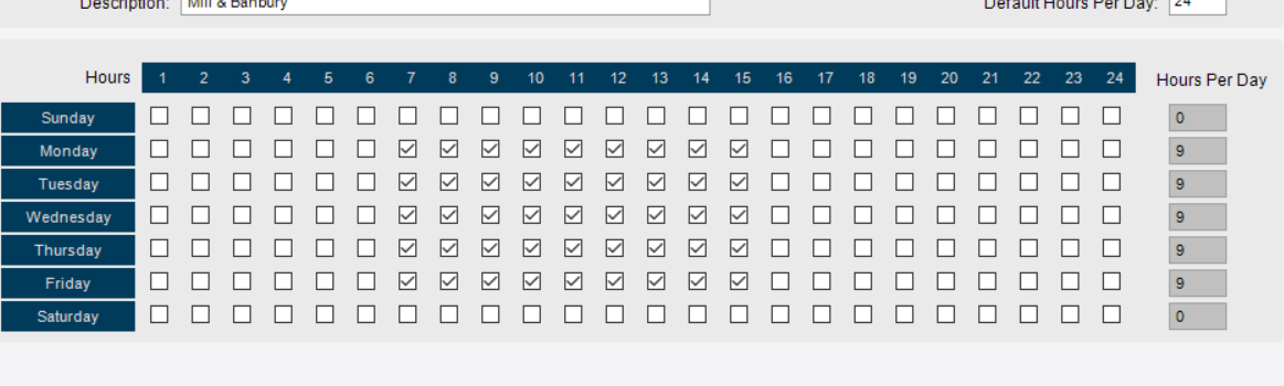

Looks like these days are blocked. Unchecking them should allow for the schedule to fill those gaps within the 9 hours per day parameter correct?
You want to go to the Working Days tab and see if those specific days are marked as non-work days.
They are not designated at all.
