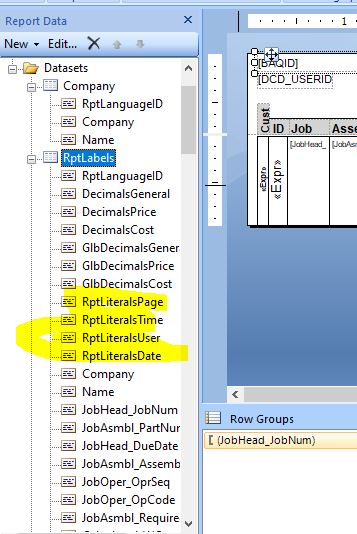

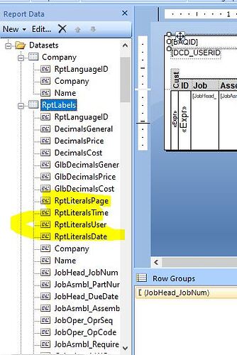

Should be there already I think
=First(Fields!RptLiteralsRptTitle.Value, "RptLabels")
BAQ Report not sure been a while.
Interesting! That field is not listed in my RptLabels dataset.
Try adding it to the DataSet Query see if it picks it up.

No I don’t think so. You can see in the first screenshot the description is there. I did created this BAQ Report by copying an older report.
I added it ok, and didn’t get any syntax errors, but it wouldn’t run. sent a server side error:
Query execution failed for dataset ‘RptLabels’. —> System.Data.SqlClient.SqlException: Invalid column name ‘RptLiteralsRptTitle’.

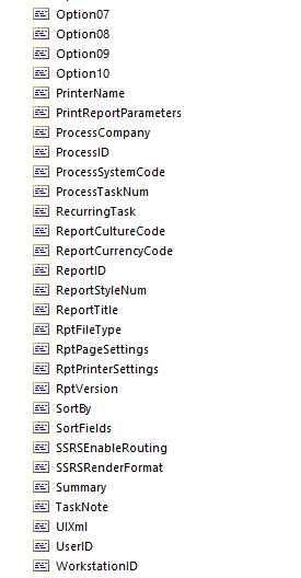

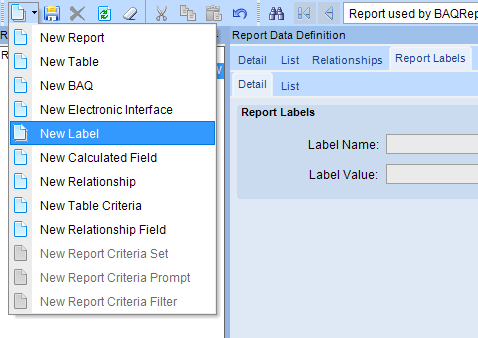

Do you have a dataset called BAQReportParameter I wonder if any of these fields have the desc
Can you manually add the label to the RDD?
Yes, I checked there. It is not in my report parameters. I tried the BAQID, BAQRptID, ReportTitle, and RptVersion fields. None of them are the description that I am looking for. :thinking:
I can try that! What should I use for the value here?
EDIT: Oh I can just manually assign the label instead of pulling the description field from the BAQ Report. Is that what you suggest?
:man_shrugging: I’m assuming you can enter a static value… whatever you want show in the description. Give it a name, and that value will show up when you add that field to the report.
Dunno… haven’t done it before, haha.
:crossed_fingers:
I think this approach might work, but it so much trouble to resync my RDD now. If there is any other way I would like to try that first. haha!

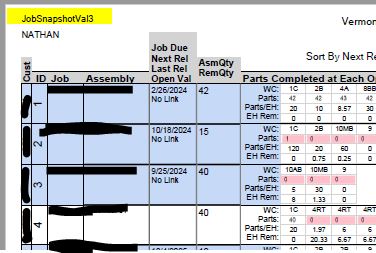

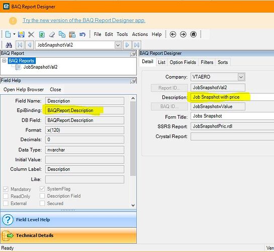

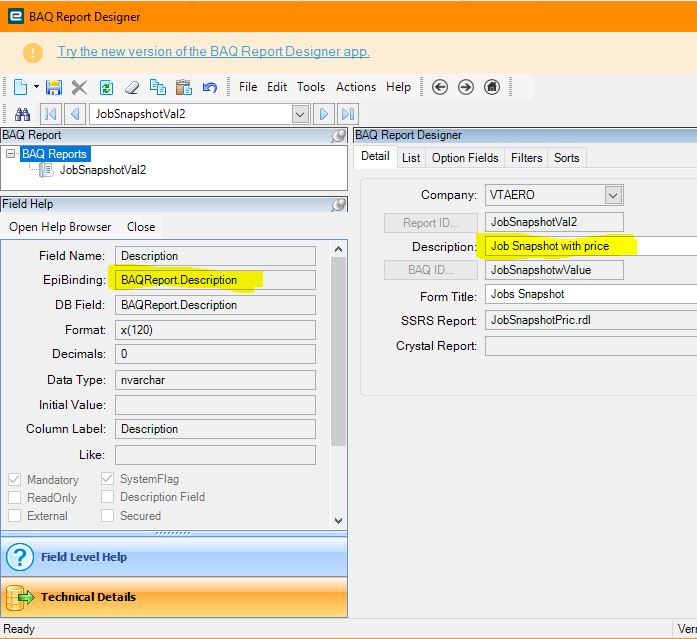

I was getting ahead of myself. There is a field right below description in the BAQ Report Designer called Form Title. I just updated the form title to match my description. Then I added this field to my report:
=First(Fields!ReportTitle.Value, “BAQReportParameter”)
This is perfect! I didn’t need the description field after all. Thanks guys!
