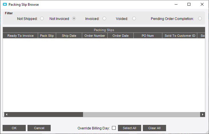

I did notice that during the Invoice Entry process, Get Shipments action, there is an option for “Not Shipped,” pictured below.
It sort of makes sense to have the option to invoice a customer prior to shipment, but there must be a way to avoid invoicing the customer again after the shipment.

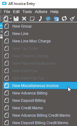

I talked to Finance and they are creating the invoices using the New Miscellaneous Invoice option.
AR Invoice Entry
They’re not using Advance Billing or Deposit Billing. When I tested creating the Shipments, the orders closed properly, but they still showed up in the Pack Slip Browse form when using the Get Shipments action during invoicing.

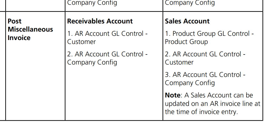

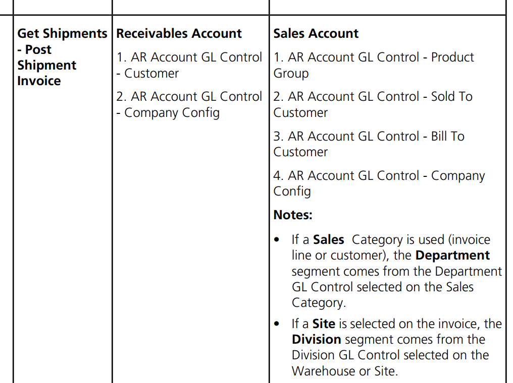

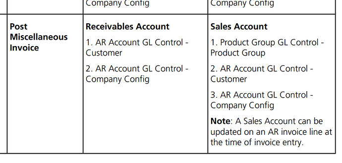

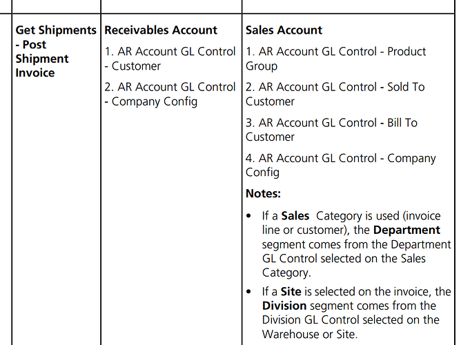

It looks like invoicing with the shipment and Misc invoice Credit and Debit almost the same accounts. You could set the $ of the sales orders to 0 and just ship them. Then just make sure you credited the correct accounts.
My background is not finance so take this with a grain of salt.
