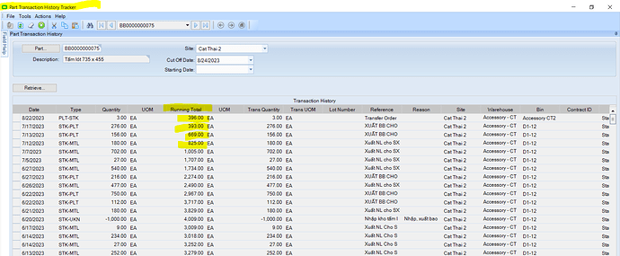

I want to know how epicor calculates inventory at any point in time?

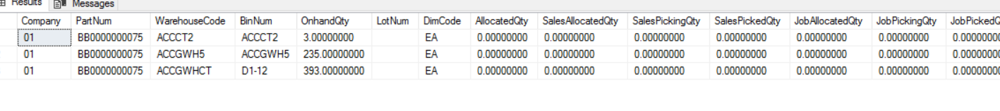

Currently the PartBin table stores the last inventory, but I want to calculate the past inventory based on PartTran but I don’t fully understand Epicor’s Trantypes
I will do 1 BPM data for PartTran table every time this table is generated I will record Onhand at the time of PartTran line generation based on PartBin table
select * from PartBin where  Company='01'  and PartNum='BB0000000075'

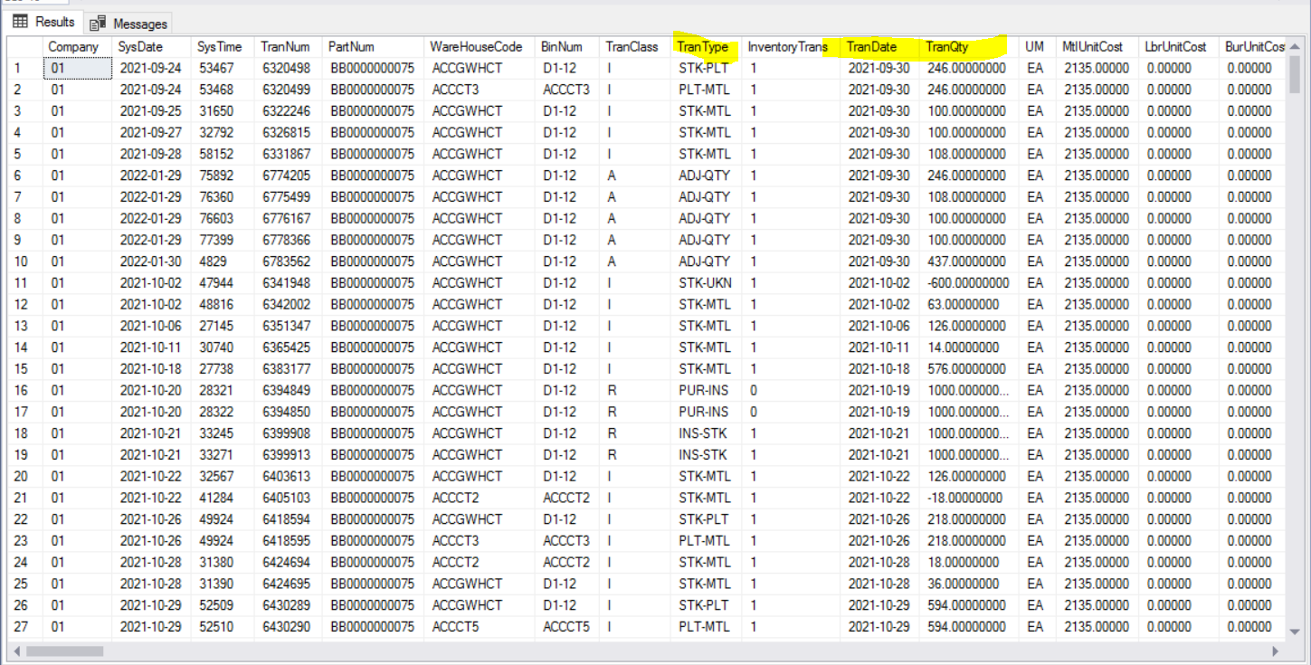

select * from PartTran where  Company='01' and PartNum='BB0000000075'  order by PartNum, trandate
I want to know how Epicor calculates past inventory based on PartTran so I can use BAQ passing PartNum and TranDate parameters (when I want to see total inventory of all Bins of Part there)

yes there are a lot but I have not found the correct answer here I just need to determine the condition in PartTran which line is input and which line is output then I can do BAQ to recalculate inventory at any time . and I will also do 1 BPM data for the PartTran table every time a data line is generated will record the inventory at that time so that later I can know the inventory at the time the data line is generated

i would remove the ‘ADJ-CST’ and ‘STK-STK’ transaction types from the case statement.
ADJ-CST transaction really is adjustment to cost, so it would not impact inventory count. yes, it does +/- the qty from old cost to new cost, but net inventory count change would be 0.
STK-STK transaction is moving a qty from one bin to another, so it also give net qty transaction of 0. (-1 qty + 1 qty = 0)
