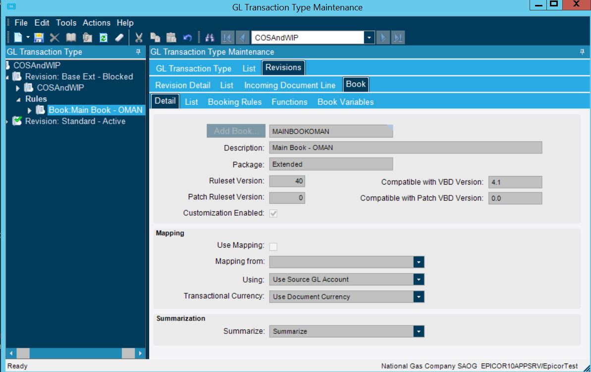

It’s a setting in the COSandWIP Posting Rule. Set Summarization to “No Summarize” if you want every individual transaction to hit the GL Accounts.
Dear tsmith, This property is disabled. How to enable and change Summarization to “No Summarize”.
You will need to create a new revision by copying the current active revision. you will then be able to change the setting on the new revision and make the new revision active.
PLEASE test the new revision in a test database thoroughly before making this change in the Live database. You want to be 100% sure of what will happen when you make the change. After making the new revision active, you will want to process all inventory transactions to make sure everything still posts as expected.
Thanks tsmith, I have created the new revision by copying the current active revision. After that changed the Summarization to “No Summarization” and made the new revision active in test application.
