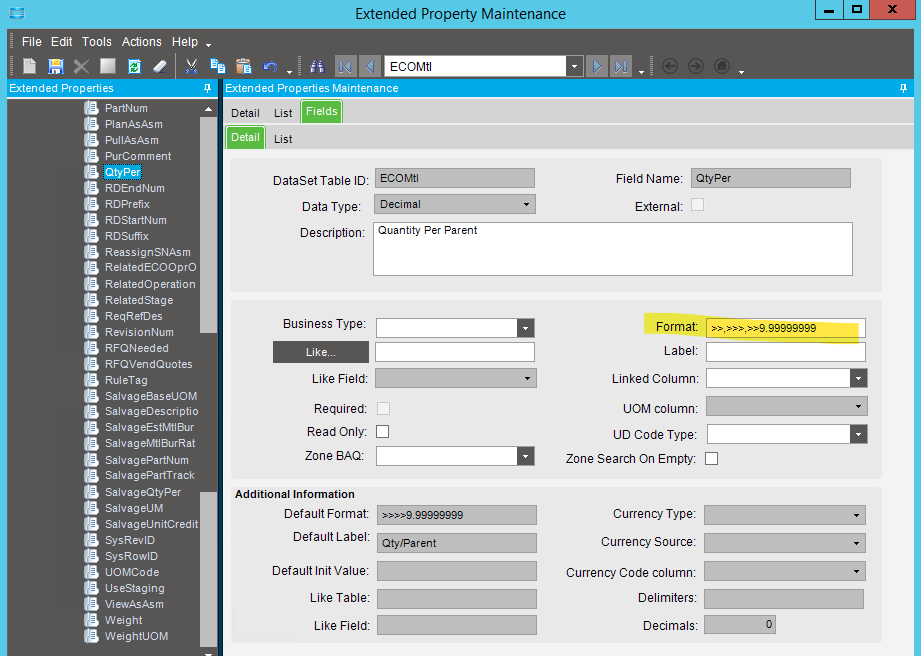

Is it possible and OK to extend the length of EcoMtl.QtyPer found in Engineering Workbench? We only have 5 digits available to the left of the decimal (e10 version 10.0.700.4) and we need at least 1 more so we can enter a qty of 100,000. I see that in the database the EcoMtl table it is showing the EcoMtl.QtyPer as decimal(18,8). In the Engineering Workbench I see Field Help is showing the field with Format >>>>9.99999999 Can I extend this without messing anything up?
Since this is a decimal value, there should not be a problem with storing the data in the field… it is probably just a User Interface challenge that allows entry.
