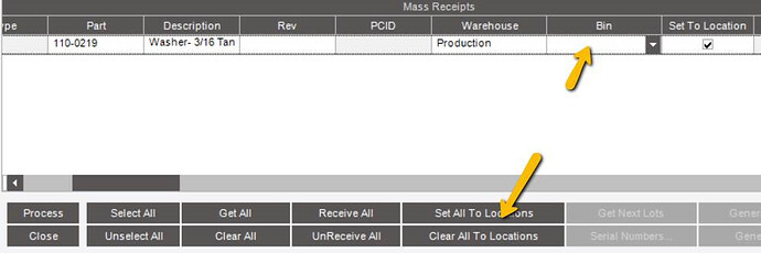

Thanks @Jason_Woods & @SueLowden for the responses. Looking into this further it seems receipt entry is not pulling the primary bin in when you press set to location:
Pretty sure this used to work in our TEST environment. We seem to have discovered this in our new PILOT environment.
Are you receiving to stock or job?
To stock
I could not find any documentation on those buttons and what they are supposed to do. I would run a trace and try to track it down that way.
Somehow our bins do not have a type assigned to them so we are looking to have Epicor provide a datafix.
