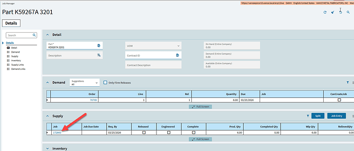

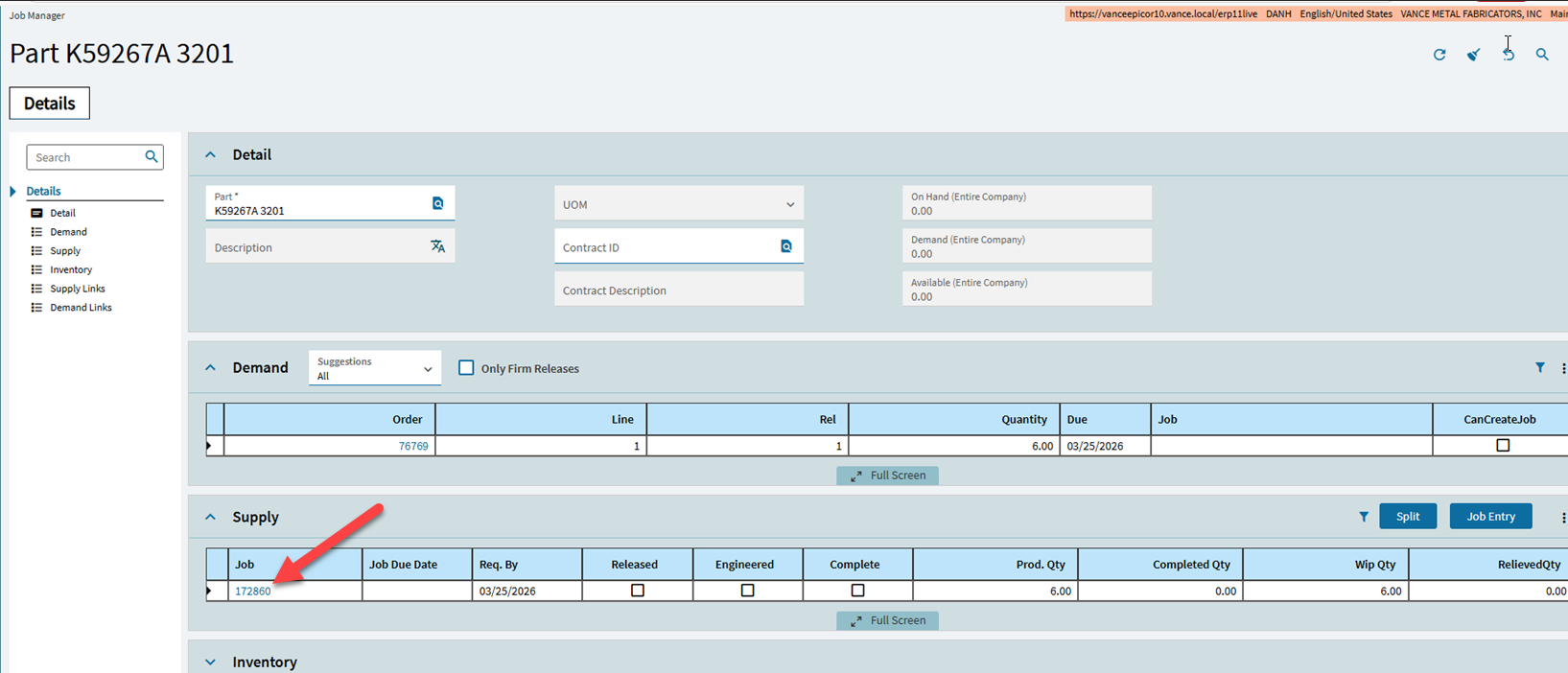

So sometimes when we right click this job number and open with “Job Entry” it opens Job Tracker instead? Any reason for this? We can’t figure it out.
We have also noticed this happening on quote entry when we hit the Engineering button on the line… it usually opens Quote Engineering Entry but sometimes it will open Quote Engineering Tracker.

Yes they have access to Job Entry and Quote Engineering Entry and it does open correctly most of the time… but maybe 15% of the time it will randomly open the tracker instead.
