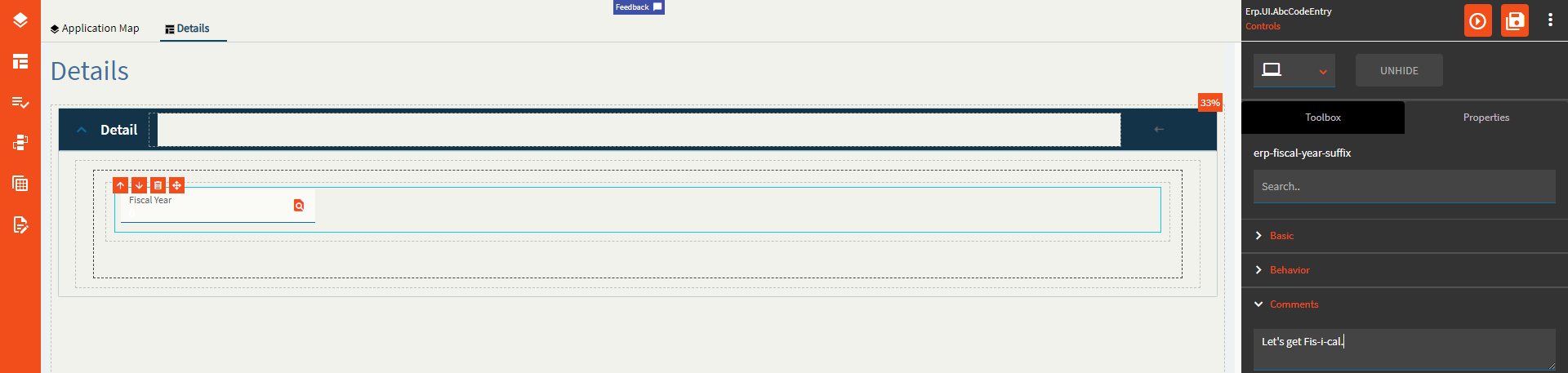

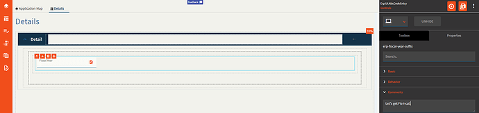

Comments | Comments | Add some developer notes to the control. These are not customer-facing and are only visible in App Studio (Fig. A) |

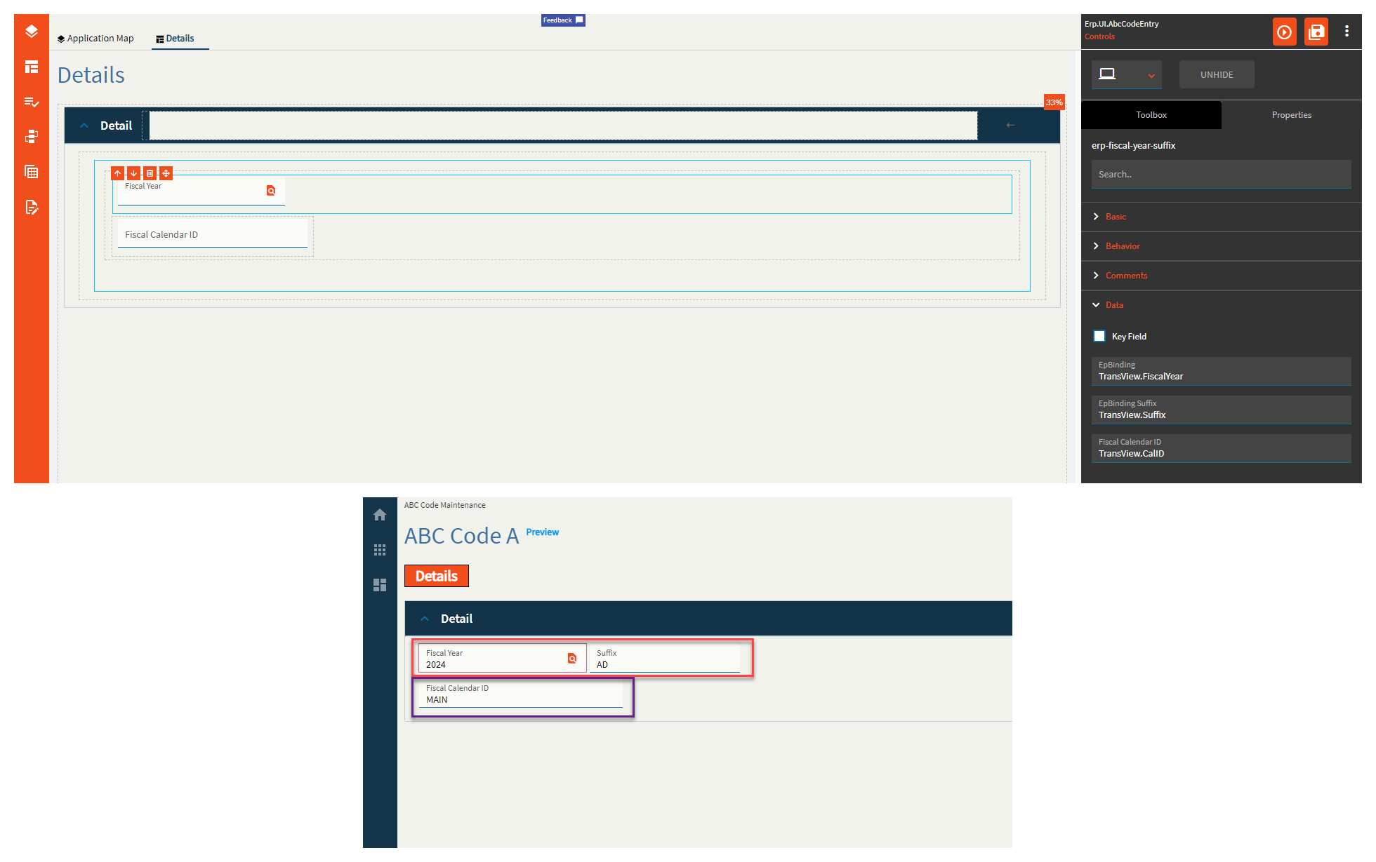

Data | EpBinding | Bind the fiscal year to a DataView.Column. (Fig. B) |
Data | EpBinding Suffix | Bind the fiscal suffix to a DataView.Column. If this field is not bound, the suffix part of the control is hidden. (Fig. B) |
Data | Fiscal Calendar ID | Binding for the fiscal calendar ID to be used in the search (Fig. B) |

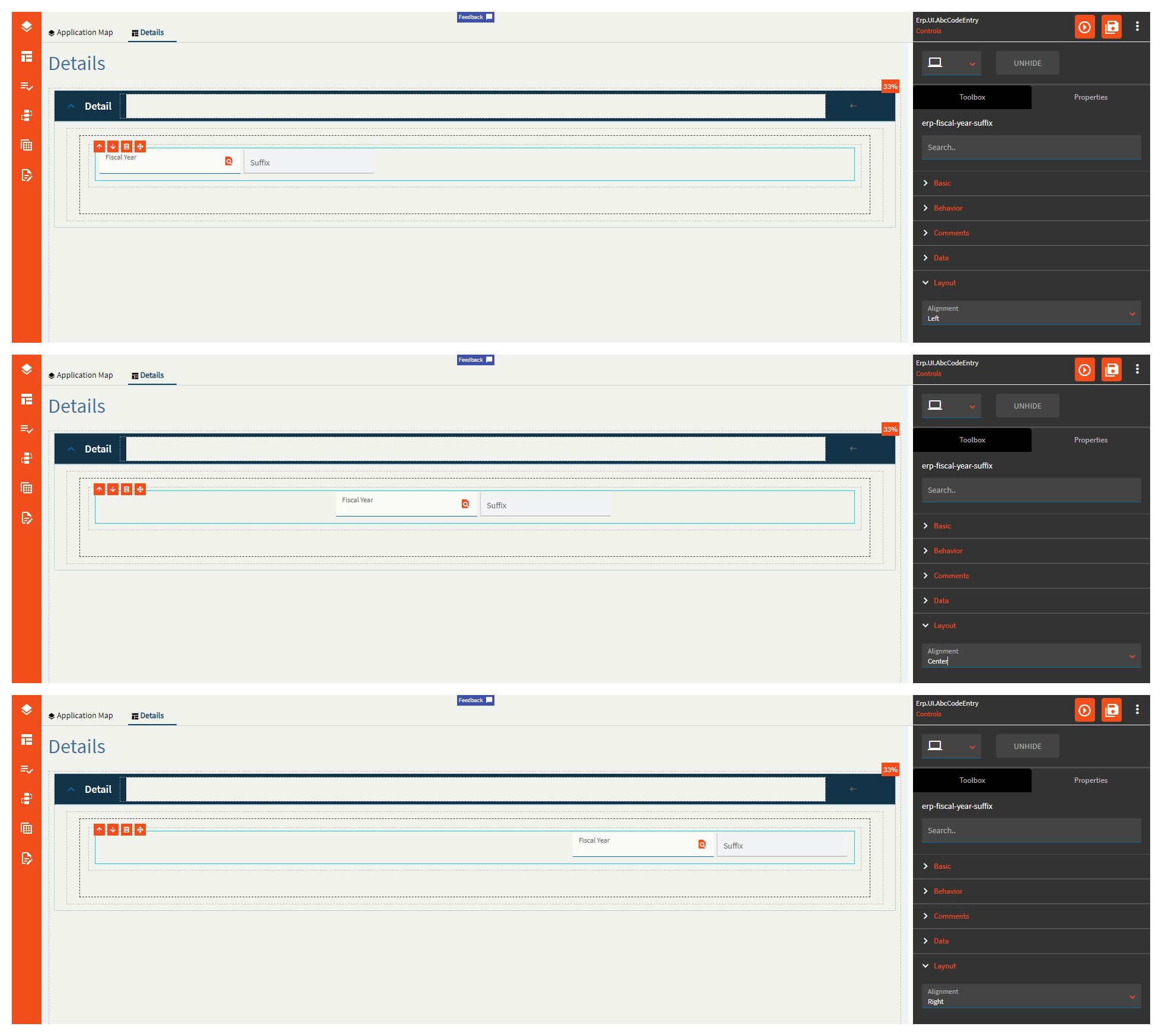

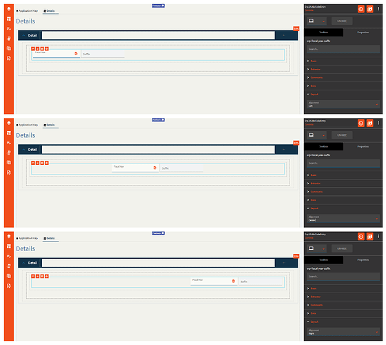

Layout | Alignment | Set the alignment for the control. Valid options are Left, Center, Right. (Fig. C) |

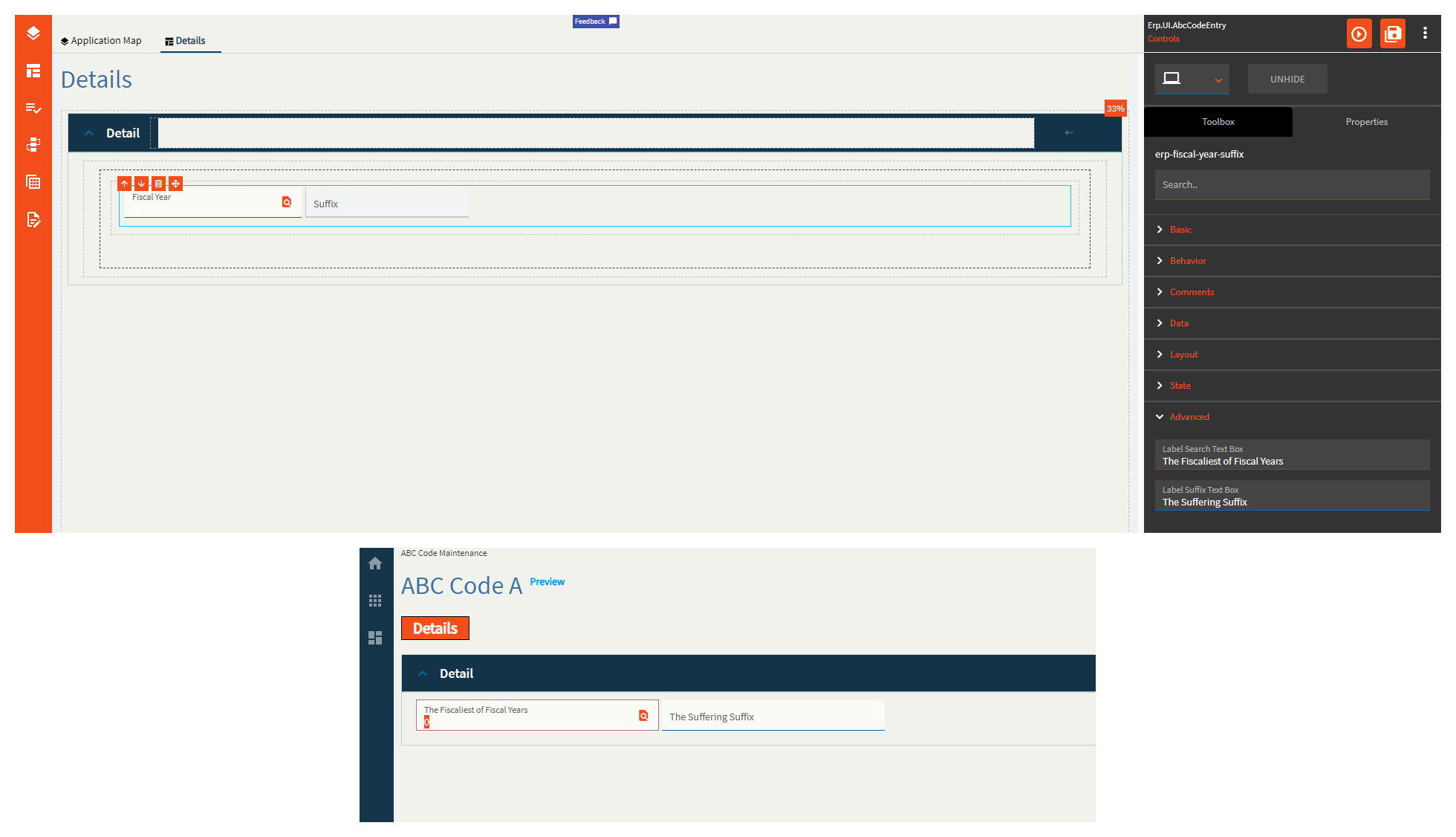

Advanced | Label Search Text Box | The label within the fiscal year control. (Fig. D) |
Advanced | Label Suffix Text Box | The label within the suffix control. (Fig. D) |
Figure A: Comments
Figure B: EpBindings
Red box is the Fiscal Year Suffix Control
Purple is a textbox I added to show the Fiscal Calendar ID.
Figure C: Alignment
Figure D: Labels
