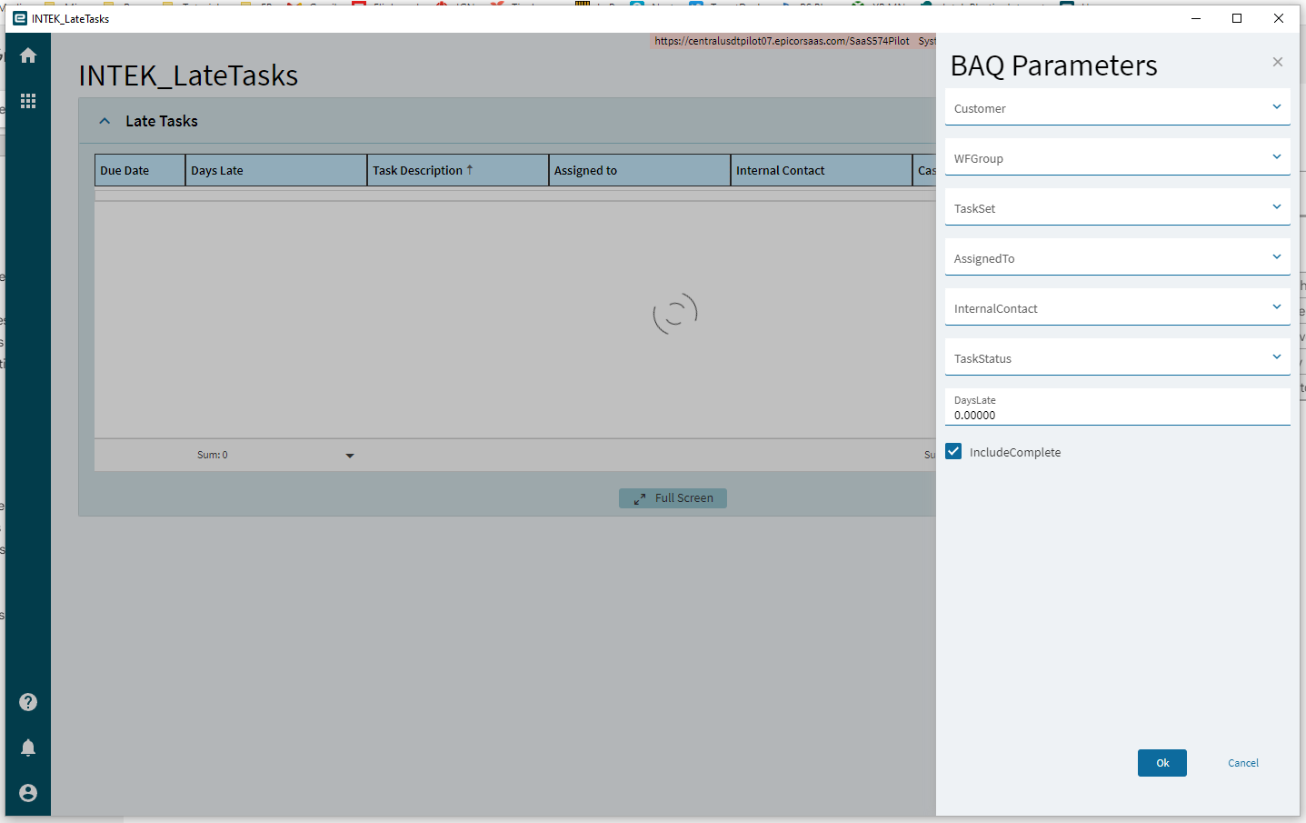

After deploying a dashboard to kinetic the kinetic dashboard does not return results.

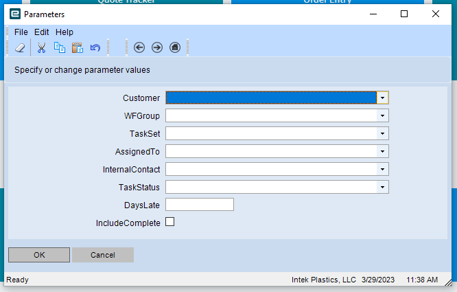

The classic one does, even if no paramaters are entered.
The dashboard conversion is garbage.
It’s best to do it from scratch.
It also looks like you’re using the client instead of the browser… ouch.

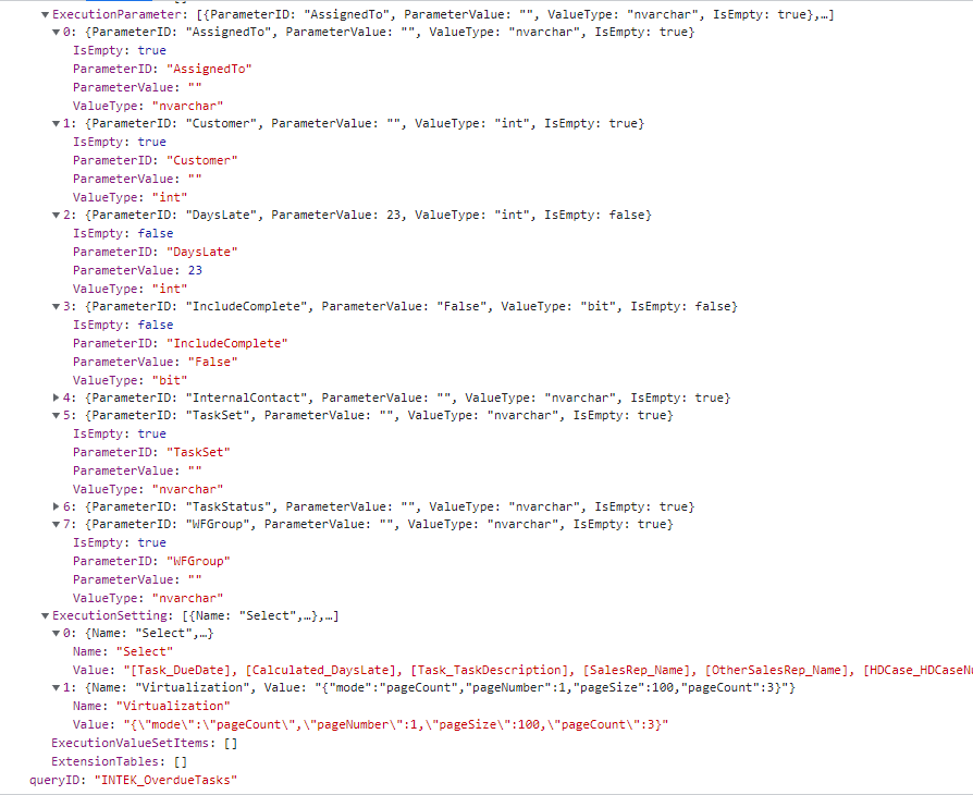

Do you see an ExecuteBAQ or ExecuteByID call from the network tab?
Yes, there is an ExecuteBAQ
With results?
No results in the values of the returned JSON

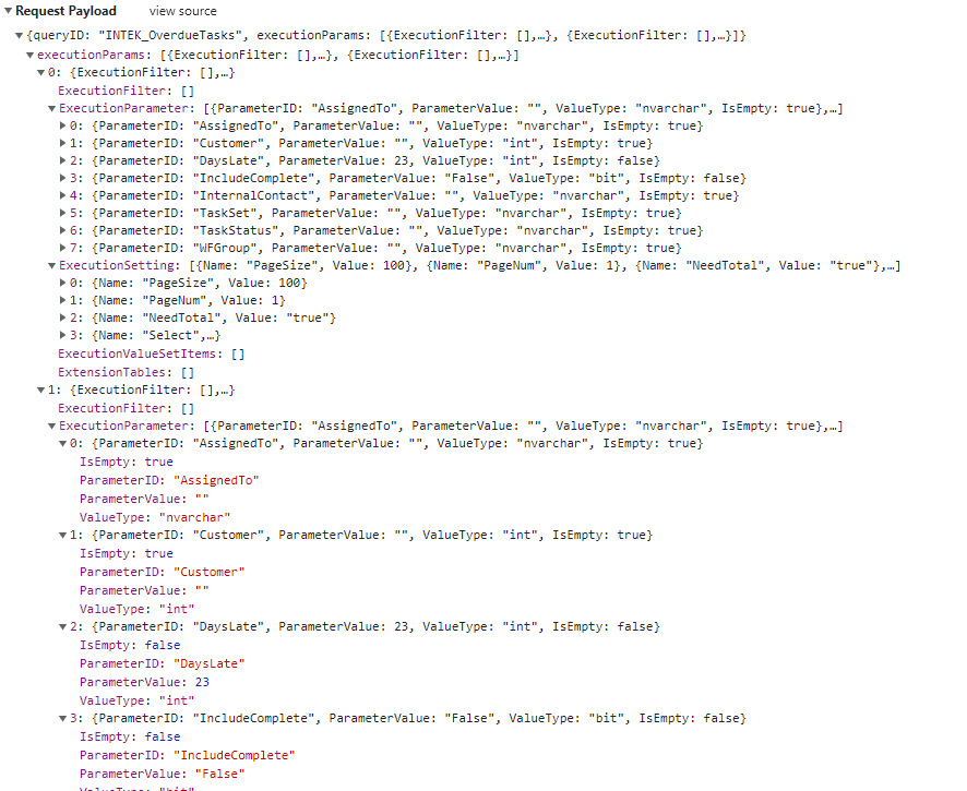

Does the payload show it sending filters in the where clause?
I’m sorry, I don’t know what that means.
There should be a tab called “Payload” within the network tab.
Expand all the carrots and send a screenshot.

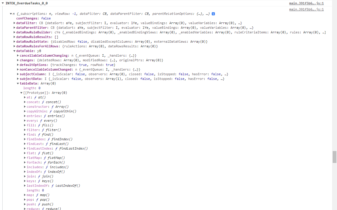

Go back to the console tab, make sure debugging is active, refresh it so the query executes, then press CTRL+ALT+V to pull up the dataviews. Does the one that’s similar to your BAQ name have data?
