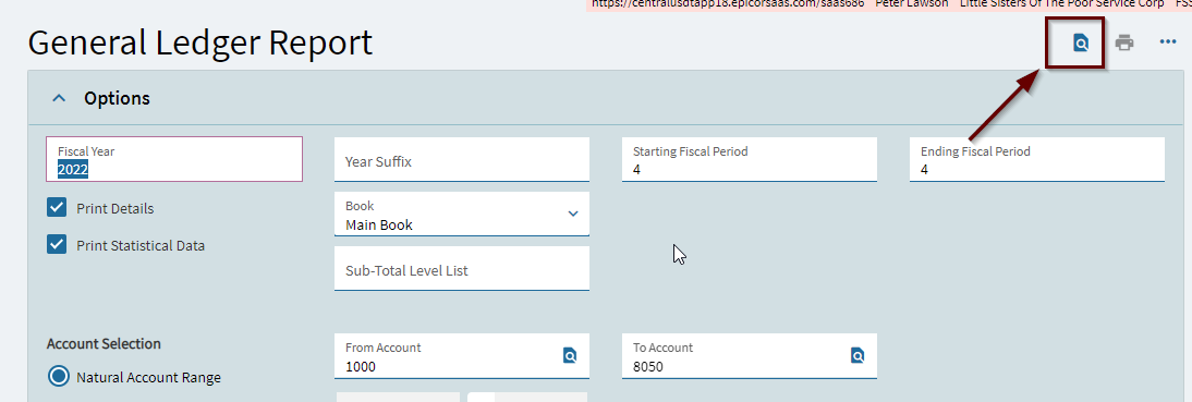

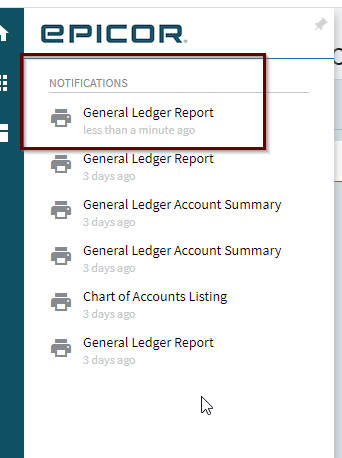

Does anyone know if there is a setting (besides popup blocker) in Chrome that would prevent reports from opening using the Print Preview feature in the web browser? see screenshot below. We try to preview PDFs/CSVs and for some users the reports pop right up and for some users it does not.
For the users where it doesn’t work, they then log into Epicor using the installed version (not web version) and all the reports immediately all pop up up at the same time. Clearly is some settong in Chrome that allows it to work for some users and not for others? Any ideas?

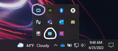

I do see this on my machine, where it does work:
Your Windows Notification area (generally) in the lower right hand side of your screen by the date and time. The same place your see the Epicor System Monitor for the .NET Client (lavender). The Edge client is circled in white.
