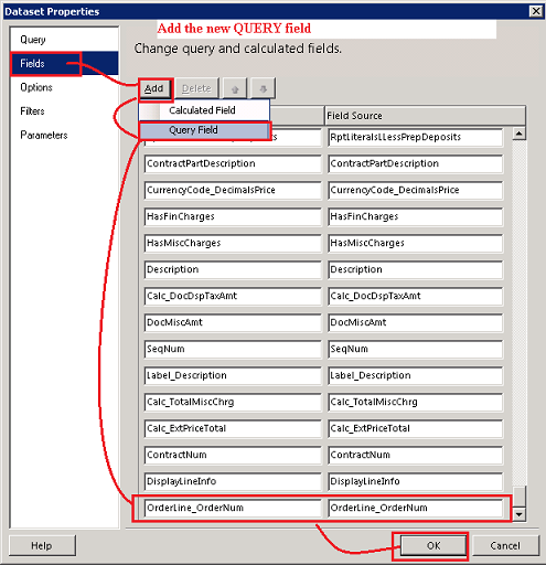

I assume you are asking about the report ARForm?
If so, the OrderNum is already in the raw data definition
But… for some reason isn’t in the query expression of the SSRS report.
Keeping in mind that the order number is tied to the Invoice LINE (not the header)
Here is just one way you could try adding the OrderNum to the ARForm report
(always make a backup first)
In SSRS, you can right click on the DataSet - ARForm,
  • open Dataset Properties
    — Edit the Query expression
    ---- Add the Field
  • close Dataset Properties
    and then add the new field to the report
Ref screen shots
