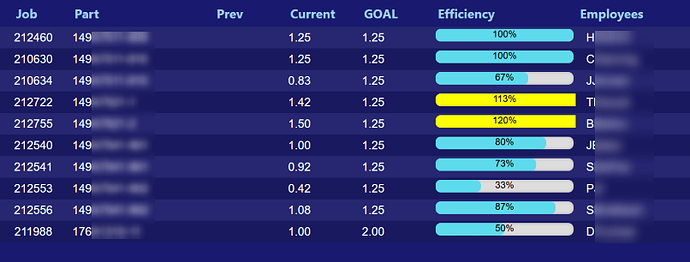

Just in case anyone else needs to create a “Live Efficiency” project, I’m sharing the basics of my method.

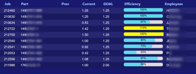

We’ve wanted a “Live” efficiency shop screen for some time, and I hacked one together recently. “GOAL” here is the ProdStandard.
This screen is displayed in all departments and gives production employees a live view of how many hours they have currently worked on a job over the standard. This is accurate to within ~5m.

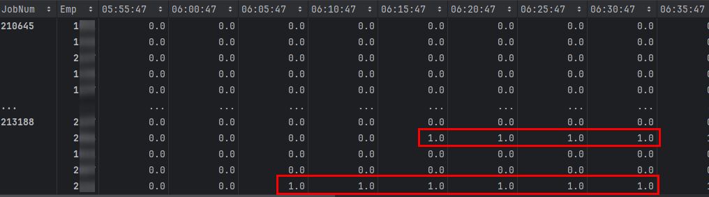

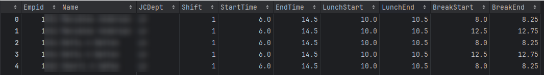

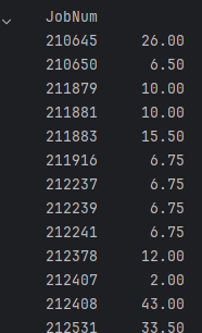

The method of putting this together comes down to a few steps, I’m abusing pandas and hosting the resultant data on our internal webserver (not SSRS!).

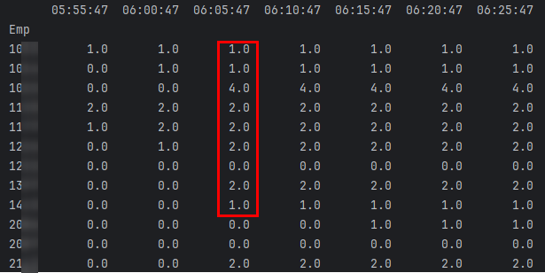

Summarize the table to determine employee division of labor (4 would .25 hours applied)
Resulting summary values can be multipled by our timeframe interval to get minutes, and /60 to get total active hours. Apply previously applied labor and voila.
I’ve got a Jupyter notebook that does this as well that I could sanitize and share if someone else needs to do this.
I’m sure this isn’t the best method, but it works and I’ve never seen another Epicor shop with something similar.
If anyone has a better or similar solution, I would love to see it and compare notes!

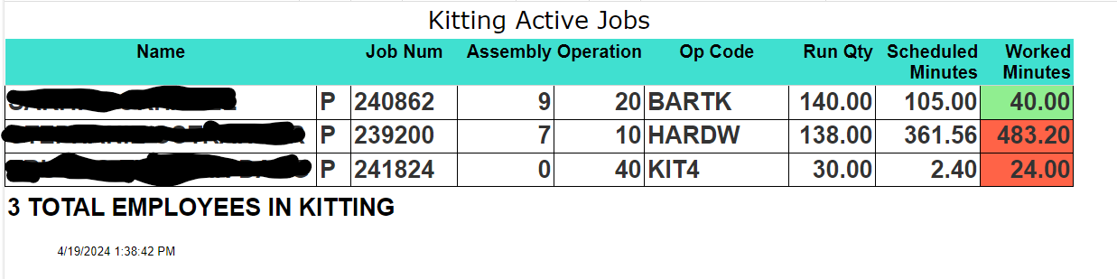

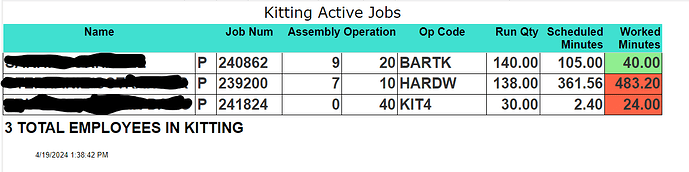

We use SSRS with a 90 second auto refresh. The worked minutes will turn yellow as they get closer to scheduled minutes and turn red once they go over scheduled minutes.
