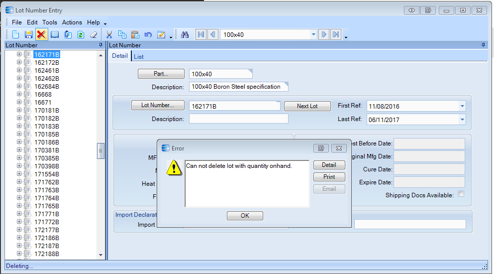

Lot number with a * 0.00 and will not remove from system?
Hello, we want to remove some old lot numbers from the system but i have found the ones with * 0.00 will not remove. i looked for a data fix but was not able to see any that would resolve this issue.
