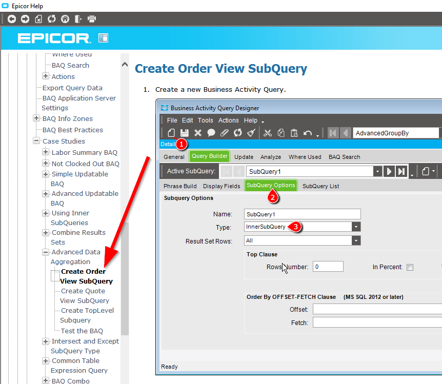

And make sure you read the tools user guide (it’s right in help) on the BAQ section. They give you step by step examples of using aggregate functions.
