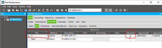

Part # 57-06200-00-1 has revision A approved. (3rd screen shot below)

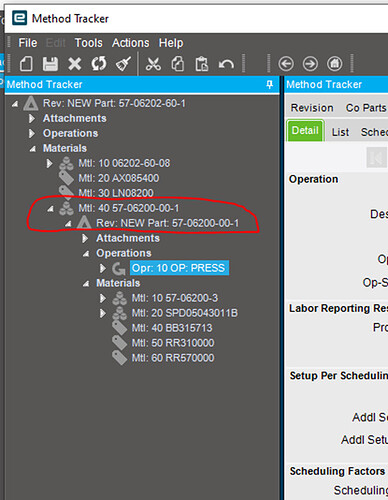

Part # 57-06202-60-1 if you look at method tracker and expand the tree, part # 57-06200-00-1 says it is at rev New. (1st screen shot below)

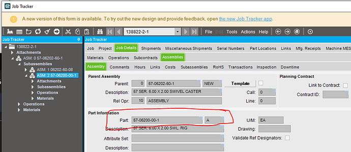

Last screen shot is the job, I was concerned since Engineering Workbench and Method Tracker showed different what the job would do so I had sales get details in the job to check.
