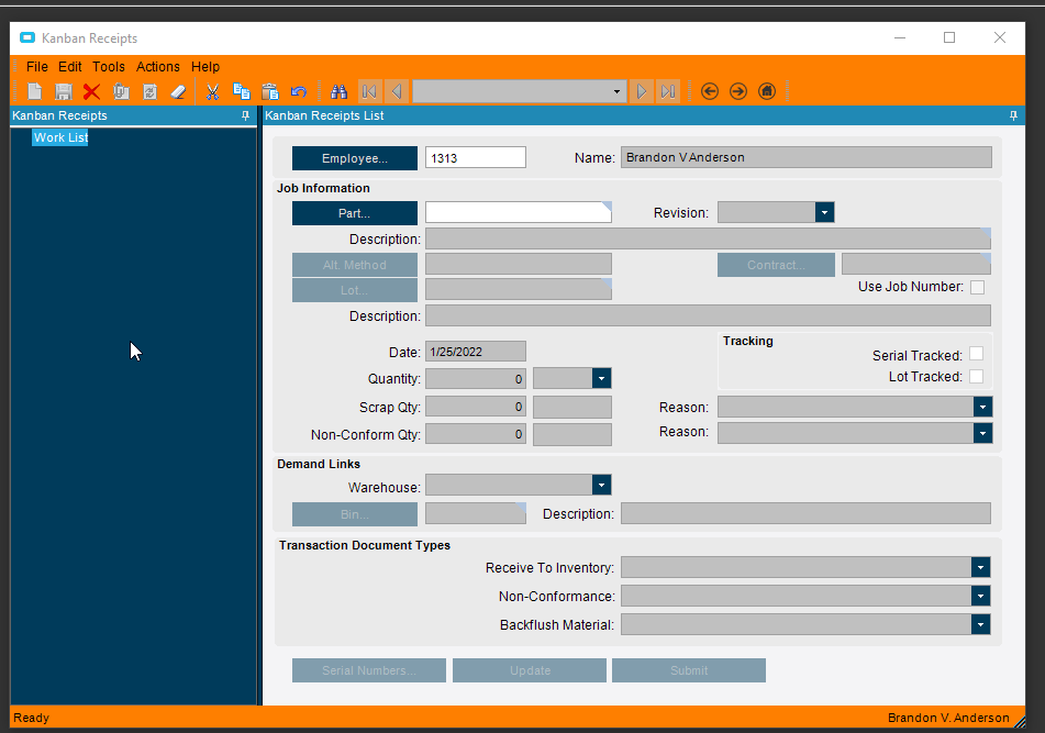

MRP doesn’t make Kanban parts. Kanban jobs are done with the KanBan receipt screen. When you do the receipt, it back flushes the material and labor. The whole point behind Kanban is to not need scheduling. You make things as you need them.

I don’t understand what you are trying to automate. You put in the part number for what you made, how many you made, and what bin you put them in. You need all of that, so there’s not much left to automate.

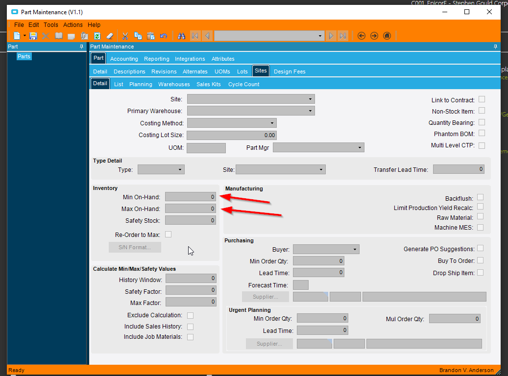

No, that’s not what Kanban jobs are for. If you just want MRP to plan jobs for you, go to the inventory section on the part plant tab and set the min/max on hand values, and MRP will plan jobs to keep your stock at those levels.

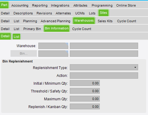

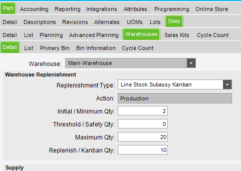

Kanban has to be setup at either the warehouse or the bin level, not both. Once done it will appear in the related Kanban monitor.

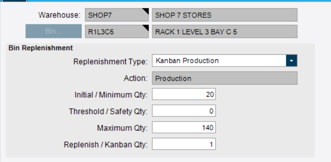

There are two Kanban monitors. Kanban Monitor and Kanban Bin Monitor. It’s not clear but the Kanban monitor only shows you Kanban parts that are setup at the Warehouse level. If you set up Kanban at the bin level, you need to use Kanban Bin Monitor (which is how your example is setup).
Warehouse Level:
Bin Level:
