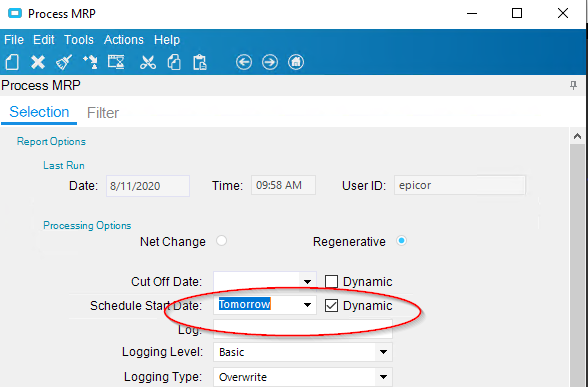

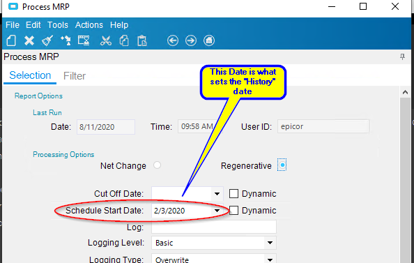

A VERY common mistake that can cause this (and you may have this as well)… What is the date that you are running MRP for? If you submitted MRP run on a nightly schedule, and forgot to choose the “Dynamic” checkbox, then you froze the starting date… that date is the date that MRP uses to determine when “history” starts.
Instead you should use the following setting here:
