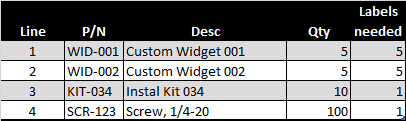

I made a BAQ Report that allows our Shipper to enter an order number and select which line items to print labels for. Some of the lines need multiple copies of the label.
Take the following order as an example:
ignore multiple labels for a moment, the BAQ prints as a single report, with 4 labels (one for each line in the SO)
Selecting 5 copies during printing would give that many of every label (a total of 20). I want to end up with (12) labels. Basically, print row 1 (5x), row 2 (5x), row 3 (1x) and row 4 (1x).

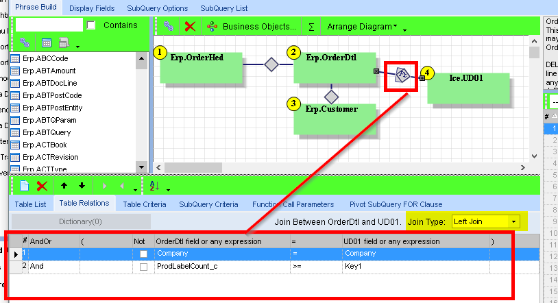

I ended up using what @utaylor described.
I have a UD table (UD01) with sequential values of 1 - 1000
My BAQ has a Left join to UD01, with the following relations
So the dataset the BAQ creates will have a qty of ProdLabelCount_c rows for each OrderDtl record.
For example, if OrderDtl.ProdLabelCount_c is 5, then 5 rows are returned from UD01. This creates 5 duplicate rows for this OrderDtl record
