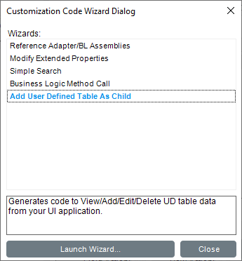

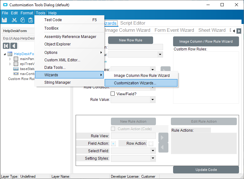

Try the “Add User Defined Table As Child” wizard. It does most of the work to set up a UD table as a child. After running it you will have a new item in you new menu and a new EpiDataView that you can bind to a grid.
Thankyou this looks promising, so it would create a case child table ?
Yep. Run the wizard, save and restart your customization. Then add a grid that is bound to the new UD table, save and restart your customization again and play with the results.
