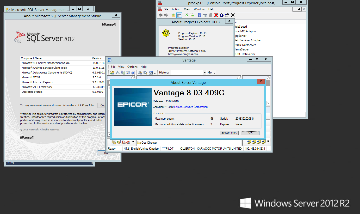

I must be doing something terribly wrong here, as I have read above that it will not work, yet we are using this now
Granted this is on our test system, but the functionality is exactly how we need it in our live environment.
Refer to @aidacra’s response above, the SQL version doesn’t matter. The issue is the version of the OS that runs open edge, and yes you can hack it to work (on some versions) but it’s unstable at best, and it is not supported.
